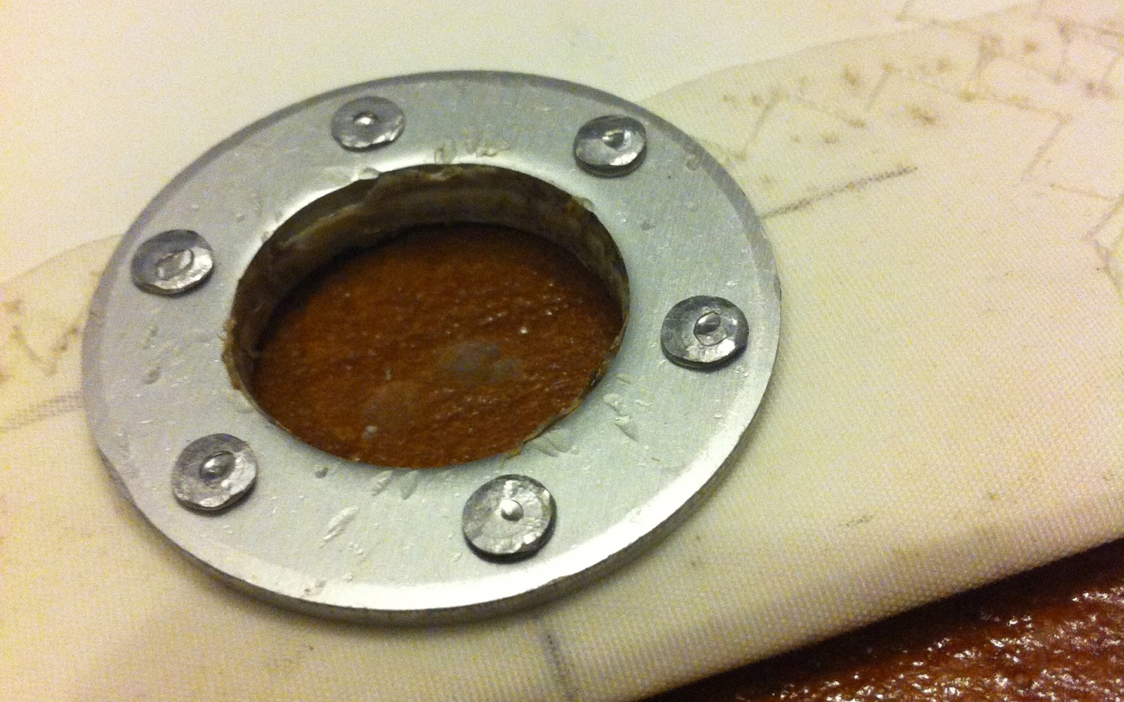

I recently put my own reef points in a few sails. I wanted reefs added to both main and hanked on head sails so bought spur grommets and the dies to go with. For a 3rd reef you really don't really need the intermediate points to take up the bunt though, so I considered trying the $4 sailrite jiffy grommets & DIY.
http://www.sailrite.com/Jiffy-Grommet
Its fairly straightforward DIY, 2 reinforcing patches and 2 grommets for a 3rd reef.
