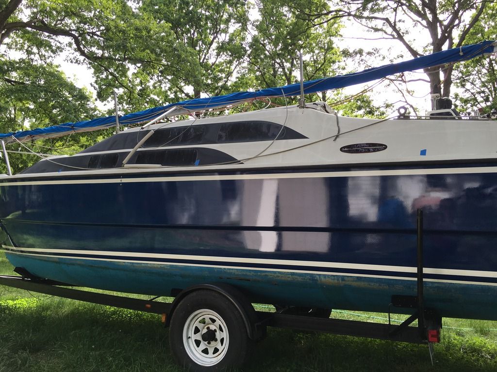

Post by Québec 1 » Wed Jun 08, 2016 4:58 am
http://a65.tinypic.com/9s84k4.jpg[img]h ... 9s84k4.jpg[/img]
This is a 13 year old hull.,the black stripes will be done when it stops raining

Now, that's one shiny hull! Mine looks pretty good using Colonite Fleetwax, but not that good. :D
My decks are chalky, though. Milky water running down the driveway as I was powerwashing it. I may have to give that stuff a try on the decks. It pains me to see gelcoat get like that. :cry:

I'm doing the decks and antiskid surfaces this weekend. NG2 does not make it slippery like wax. I haven't touched the stripes since I applied NG2 last July (previous detailed post).
Great effort or should I say little effort compared to repeated buffing and waxing!
