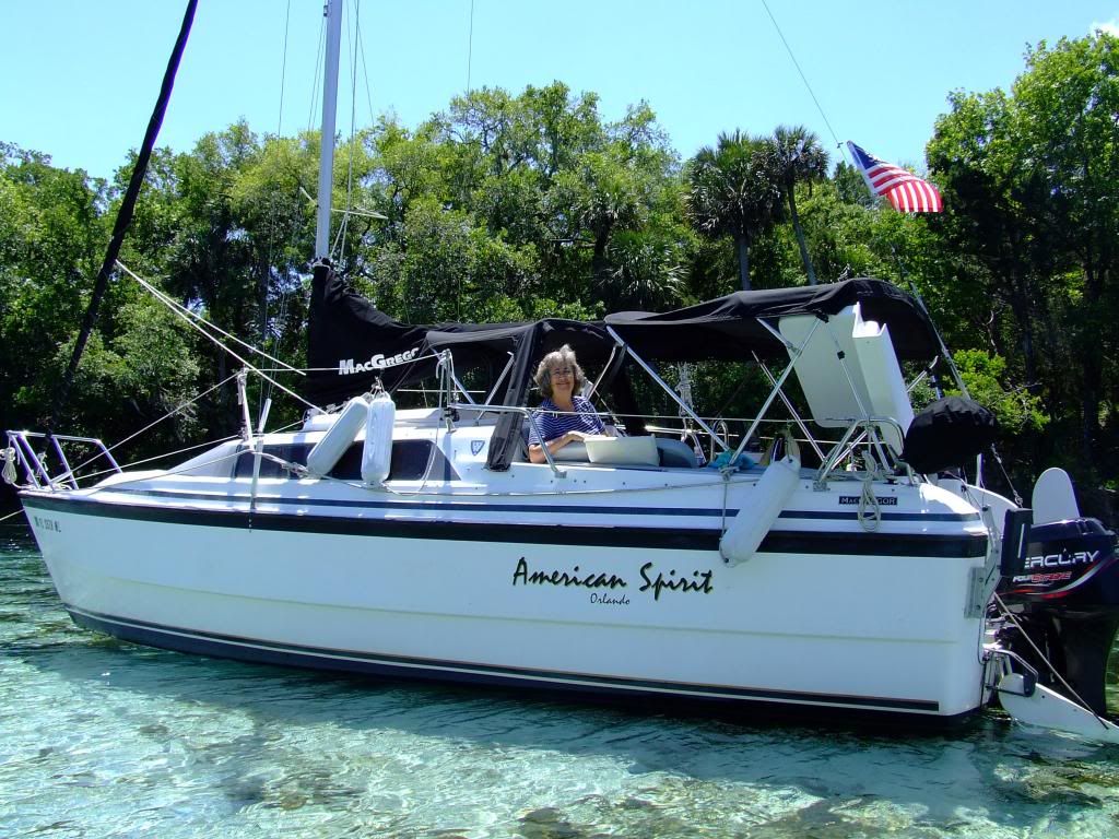

Post by Herschel » Wed Jun 15, 2016 8:07 pm
My boat name is on with vinyl letters. Will New Glass attack them?
When I used NGII on my X three summers ago, I do not remember any issues with my letters of the name or the registration numbers on the bow. I think I remember going a little easy around the letters. It may be prudent to test a small corner of one letter to see how your particular letters respond to the NGII. You can, also, contact the maker of NGII. I remember calling them about something, and they were very helpful. My lettering came from West Marine about 12 years ago, and they still look good.
