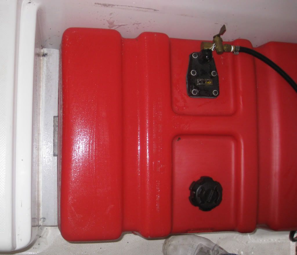

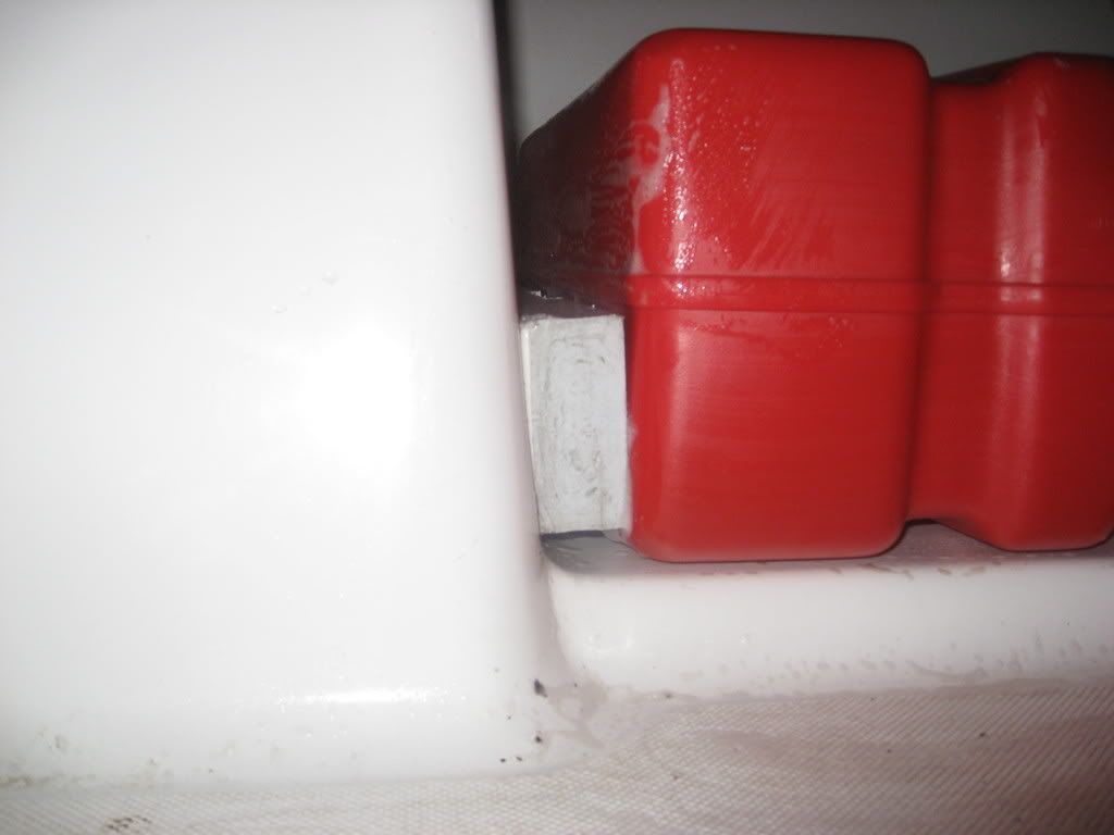

OK, I was able to snap some pictures of what I did for securing the fuel tanks. The longer 2X4 is really just a spacer so the tank does not slide forward. I used PC7 epoxy to secure and caulked the edges just to make it more appealing. I also drilled a hole into the the blocks so I could run a line over the top of the tanks in case I needed more securing. This setup still allows for removal of a tank if needed. and a clean look when finished.
After I figured out what I wanted to do it really only took about 30 min. and less then $15 for epoxy and caulk.
I have had the boat over about 35 degrees with full tanks and there was no movement. I need to have Ray take me out one time to really lay it over.
Image[/img]

Nice Job ! NOW I have to run out the the garage (I emptied mine for use in the snow thrower and Tractor :x ) and see If I can do the same...
YES I DO SO YES I CAN! I never noticed those indentations You are one clever and observant fellow!!

Hi Matt, many thanks for your trouble to get these photogrophs for me. This mod looks like the way to go for me. May even attach a strap to go over the top of the tank to prevent the tanks from bouncing around.
Whats best is no screw holes.
Thanks everybody for your input and those that have not done this mod (or simalar), strongly recomend that you do.
