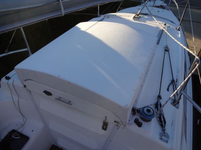

The bottom 6" or so of the :macx: board is hollow and then there was a small hollow channel running up to near the top where it flared out and became hollow again if I remember right. I wanted to experiment so filled the drain holes with 5200, drilled a hole at the top and dumped in #8 lead shot. 2x25lb bags fit almost perfect in the bottom 6" void and about 20 additional lbs fit in the channel going up the board. My thought was if I didn't like it it would be a 5 minute job to drill out the 5200 plug and drain the shot back out. I liked it and kept it weighted. I left the rest of the board/hanger stock and used an 8:1 purchase so it was about the same effort to pull the board up as original.
Pic from setting up the lift line- Only issue was after a few seasons was the doublebraid would chafe quicker where it bent to go through the deck, dyneema seemed to take care of that and had less friction.
