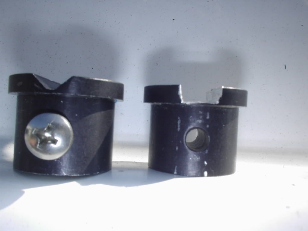

Here's my link to my photobucket site
http://i235.photobucket.com/albums/ee20 ... 0023-1.jpg
http://i235.photobucket.com/albums/ee20 ... 010020.jpg
bottom spreader end caps modified to eccept two sets of shroulds side by side "not on top of each other" original top shrouds are now middle shrouds and I added a third set of shrouds which now become your top shrouds or masthead shrouds
http://i235.photobucket.com/albums/ee20 ... 0007-2.jpg
http://i235.photobucket.com/albums/ee20 ... 0005-1.jpg
http://i235.photobucket.com/albums/ee20 ... 010004.jpg

Thanks Highlander, a picture does tell a thousand words, you've supplied about 5000 plus 2 vids, the pics leave no doubt how you assembled your rigging.
