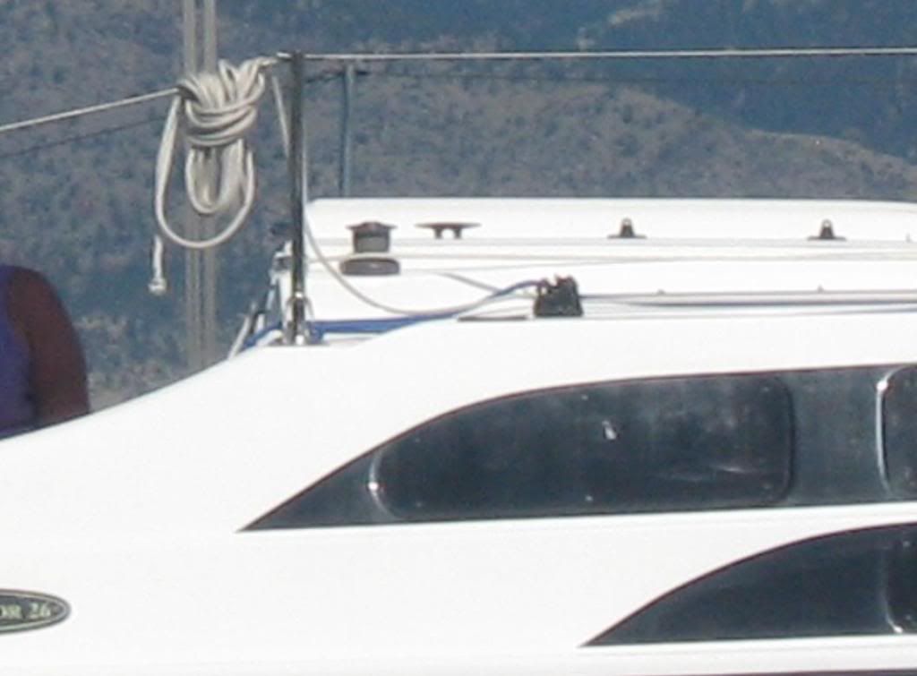

- Posts: 8299
Re: Rope Clutches
However, now that I think about it, I have used the winch a couple of times to tighten up the main halyard.Wayne nicol wrote:sorry, let me clarify, my clutch's are forward of the winch by about a foot, but out of alignment by at least 6" so there is no way you could use the winch to snug up a halyard, or even use the winch to un jam the clutch- oh well!!!!
Mine aren't lined up very well either. And I see what you mean. I never need the winch for the dagger, but the haylard is another story. So I made sure the halyard is the INSIDE (closest to the winch) Spinlock cleat. This way there is less sideways pull on the cleat. I wouldn't want to put too much winch pressure on those because your are right, they might pull sideways and bend/break the clutch cleats. But I have been able to winch it up tight.
This is the way BWY rigged my boat and I feel it works very well.
Main haylard is coiled up on the lifeline. Blue line is dagger board line. Hard to see. Sorry, best photo I could find.
BTW, I have no idea what that top cleat is for. I've never used it.
