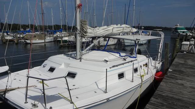

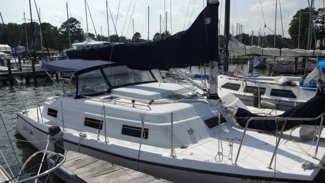

Hey dave, I have looked at a few and think I have looked at the one you are talking about if it has a teak door (most are fiberglass). Have you looked at it in person yet? If it is the one I am thinking of there were a lot of items I noticed on it, some good, some not. I think it is actually the prototype. It looked identical to the very similar intercat 28 which was the original mold. It has the same forward cat mast and fixed motor mount. The one I am thinking of has custom sugar scoops added to the rear to make up the 30' length though.
This is the one I am thinking of with the forward mast
And the standard mast location

Post by davesisk »
Hey Seapup...yes, I have. And the pic you posted sure looks like it. Lickety Split in VA? Yanmar diesel outboard on a fixed motor mount? (That's the worst thing I saw...I know there are jackplates to add hydraulic lift to that heavy motor, but I know they ain't cheap either). How well did you look it over? Did you do a water trial? I'm negotiating an offer with the seller, so I'll certainly take any info you might have.

Re: Thinking about snagging an Endeavourcat 30 catamaran...
Post by Seapup »
Same boat.
The original 2 hulls ad has it listed as being special ordered before endeavourcat 30 was officially released as a model. Endeavourcat made changes to the first production model. Being a one off may make resale value of it a few years from now something to consider.
I did not take it out or hoist the sails. I like the model, but it needs more TLC than I wanted. Please don't take any negative comments about the boat personally. It would be about a grand, but I would get a good survey of it and you will know its real value and what needs fixed.
You know the good points, so here are some of what I noticed.
Everything was original, out of production, and looked like it had minimal maintenance. All electronics, wiring, fuel, water and other systems looked to need TLC. I would not even mess with the yanmar, add in price of new motor. Around the motor mount and transom there is cracking. The added scoops have cracking from bumping into things. All of the internal plywood bulkheads (bow compartments and lazerette) were soft. Under the mast step there was evidence of standing water.
If you have time to fix it up it could be a good value if you get it priced right. It would also be very easy to sink a lot of money into it. It is a lot more boat than a mac. I have many pics of it if you missed taking any you wanted.
