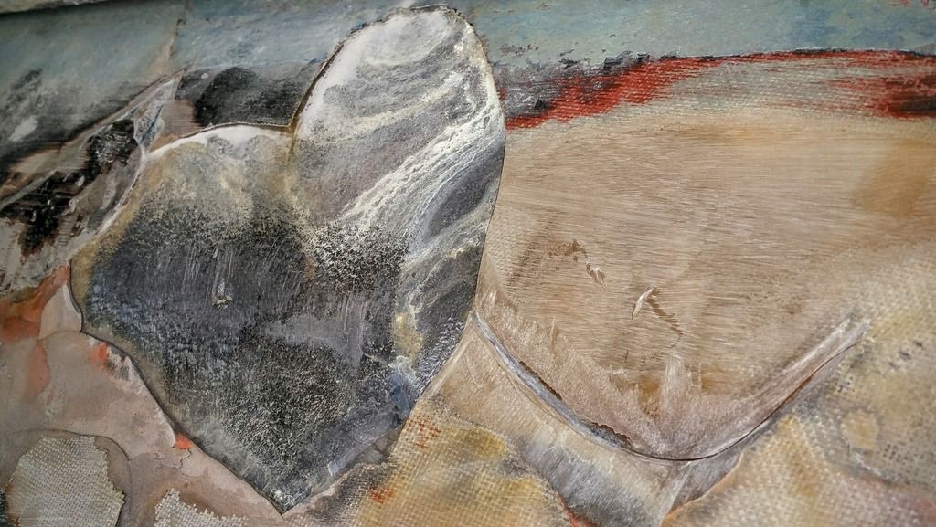

I am still working on sanding my Venture 24. I picked it up real cheap but it was in rough shape. I have been working on sanding the bottom down to glass so I could build it back up the right way. I started working on the centerboard today and came into a bad problem and I'm not sure what to do about it. I had seen cracks in the fiberglass so I started grinding them down a bit so I could fill it back in. Then the real problems started. Under the 1 layer of fiberglas was a thick layer of some kind of resin. The crack continued into this resin. In the search for something solid to start building from I continued to grind out the crack when a large (about the size of my hand) just fell off. It looks like water got under the resin and seperated it from the metal core. I think I could use some west system epoxy to build that back up but I'm not sure. The next crack seems to keep going and I could really use some advice. I have no idea what to do here.

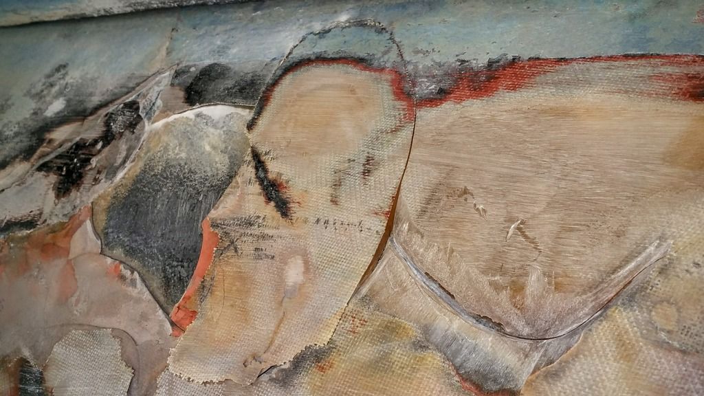

I put the part that fell out back up there for this pic

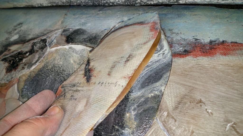

This is the part that came out. looks like really thick resin.

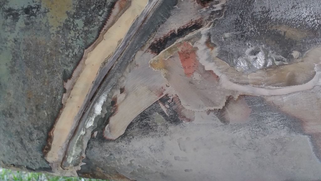

This is the crack that keeps going. I worry about grinding this out but not sure what else to do.

Sorry but that looks likes a de-lamination problem. You got not real choice but to strip off all the loose glass then re-glass with epoxy. You could try to inject epoxy under the loose glass but you will never know if you get it all and could find it just de-laminates again.
On a second look it looks like the de-lamination has been caused because resin has been used for build up without any glass reinforcing. Used some chopped mat and epoxy and build it back up.
