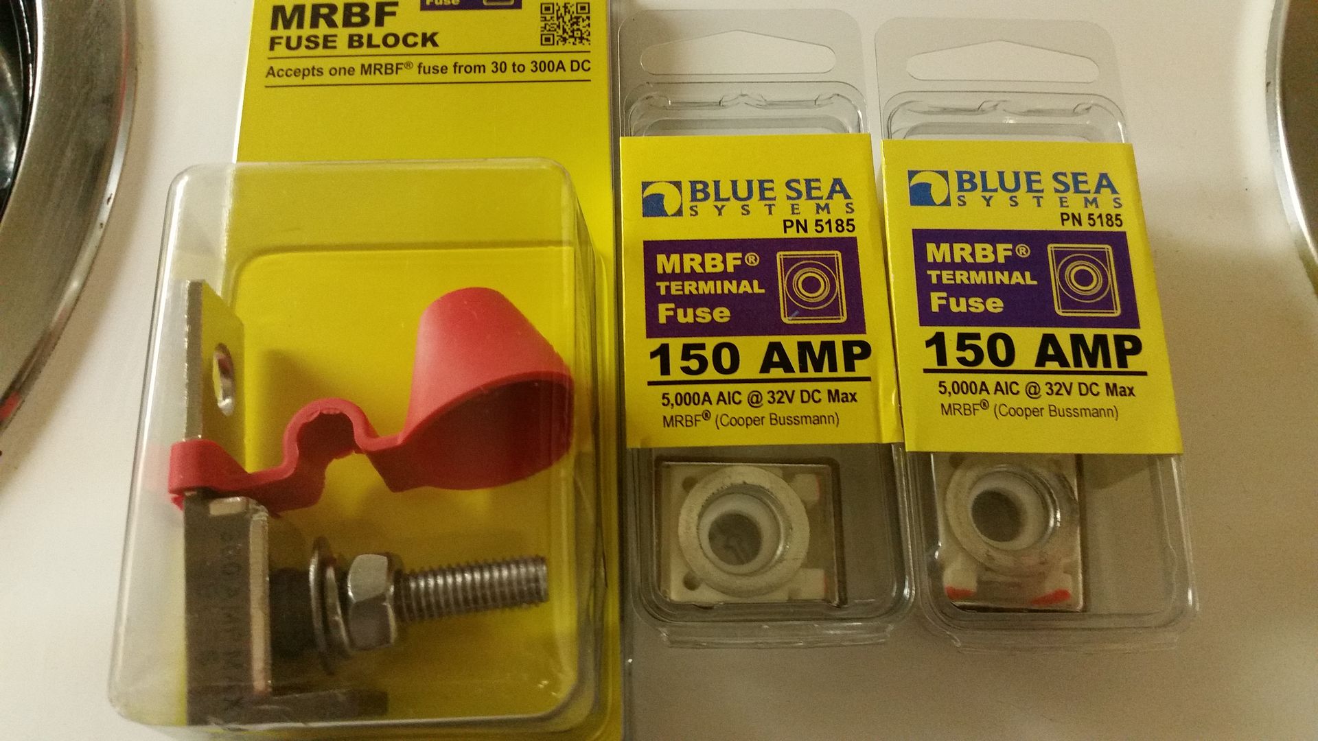

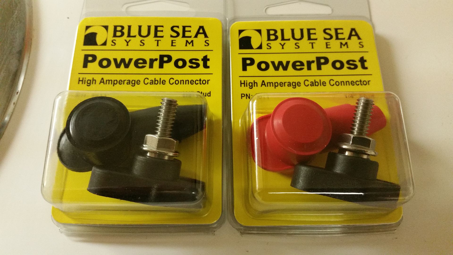

I,m in the process of up-dating my battery wiring also & doing the same mod , I,ll b installing these products when I get my boat out of the boat yrd next mon
These will be going on my #1 house battery bank
http://i844.photobucket.com/albums/ab1/ ... 6l6xa0.jpg
I already have one of these on my start battery also
http://i844.photobucket.com/albums/ab1/ ... 5rczee.jpg
hope this helps u out
