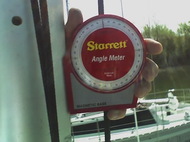

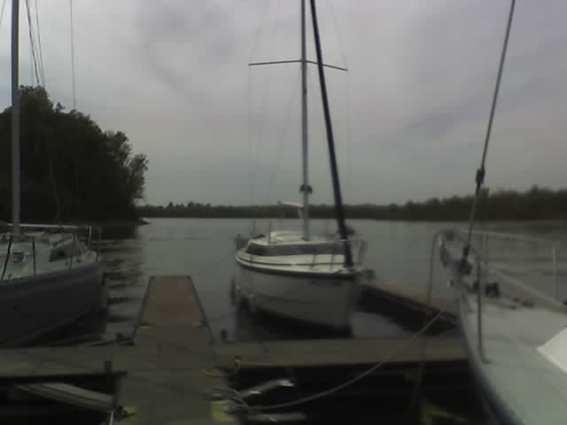

Frank C pointed out in the prev thread about this that fore aft angle is in relation to the water, not the waterline so I do it in the slip. Turns out what was 2 deg in relation to the boot was 4 deg on water. Must be that big 40 horses hangin off the transom.

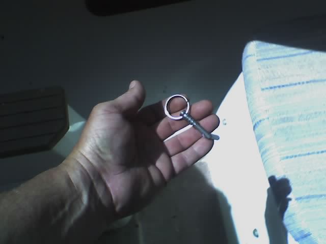

First I slacked the tension on the shrouds upper and lower. Then slacked the backstay. I inserted these quick release pins while I worked.
With the turnbuckle on the forestay I set the desired mast angle. This year Im starting with 2 deg aft of 90. Bring up the backstay to hand tight only as it will screw with the shroud settings if its too tight.

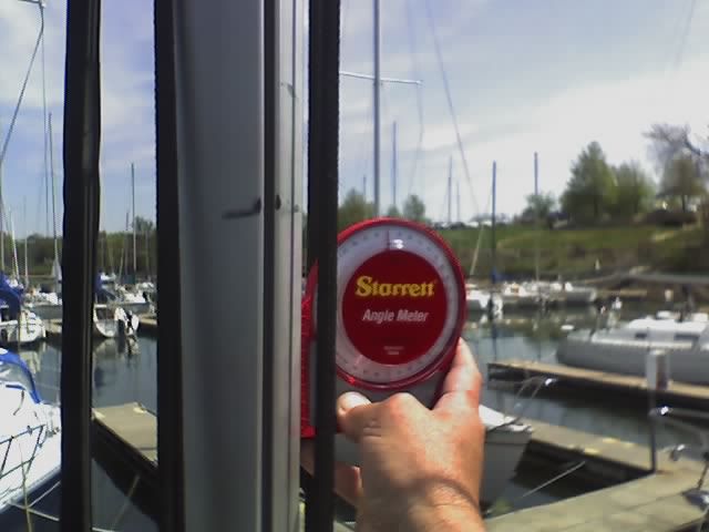

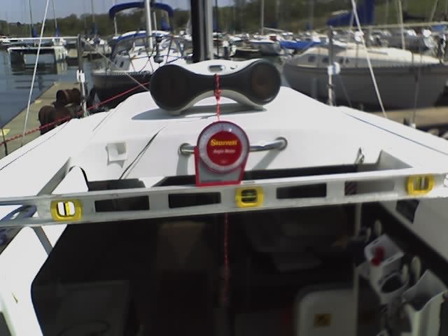

Then I put a level across the hatch so I can see it from the mast. When I check my angle (0) on the lower half of the mast I make sure the boat is level. Adjust the lowers first.
Bring it up 1 hole on each side to the just tight feeling point (Low boing or just before low boing) Checking the angle for true along the way.
Once I had this set I did the same for the uppers sighting up the mast and tightened it to just before it induced mast bend.

Be sure to replace the temp pins with the ringy dingy safety style pins. I wouldnt trust the temps.

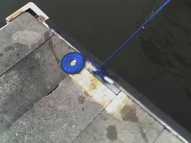

And for Bill, a nice pic of my Flemished lines.

Scott wrote: that fore aft angle is in relation to the water, not the waterline so I do it in the slip. Turns out what was 2 deg in relation to the boot was 4 deg on water. Must be that big 40 horses hangin off the transom.
My best guess is that the water in your slip is not level.
That would easily explain the 2 deg difference.
In fact, it could very possibly be off by 6 deg, in the other direction.
