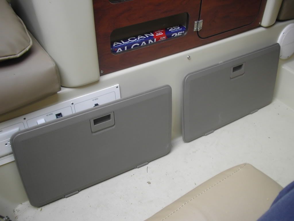

here's my shore power and 12v. outlets at the V-Berth click on the pic then you can zoom them in !
My slip hydro hook-up at the port aft side under the helsman seat
here's my main hydro 110v box with a outlet in the aft port side birth I usualy have a 6ft power bar attached to this outlet that is then hung on the side of the sliding galley
http://i235.photobucket.com/albums/ee20 ... 010078.jpg
this outlet will be moved to the S/B side directly oppisit from where it is presently mounted aft port seat to the aft dinnette seat being moved for two reasons one it will give me outlets on both sides of the boat
http://i235.photobucket.com/albums/ee20 ... 010080.jpg
Two , to make room for these new storage hatches
http://i844.photobucket.com/albums/ab1/ ... 010016.jpg
Hope this gives you some idea's this set up gives me access to 110V & 12v outlets on both sides of the boat and up front without having to run extension cords all over the cabin sole
