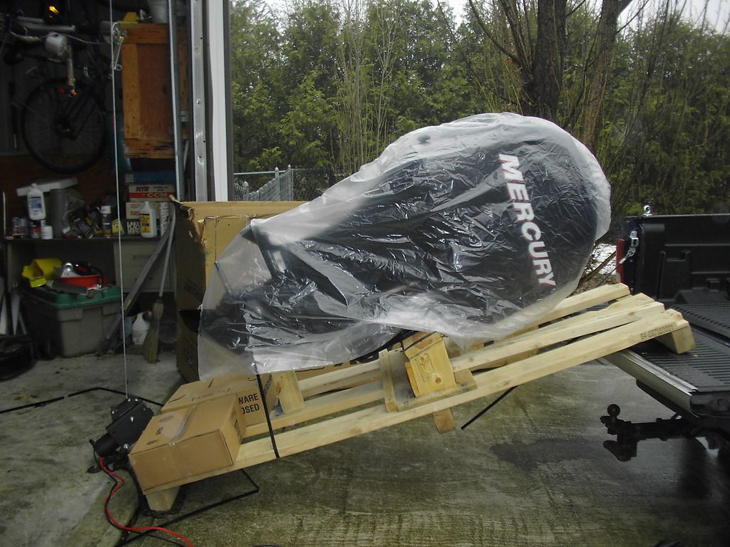

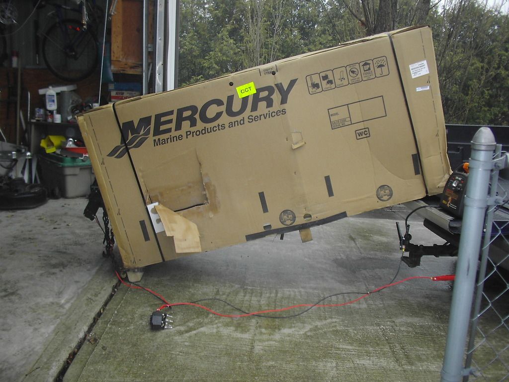

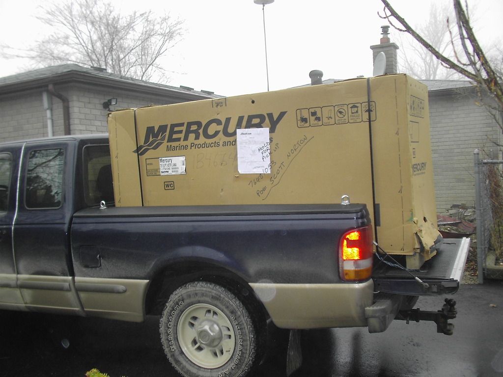

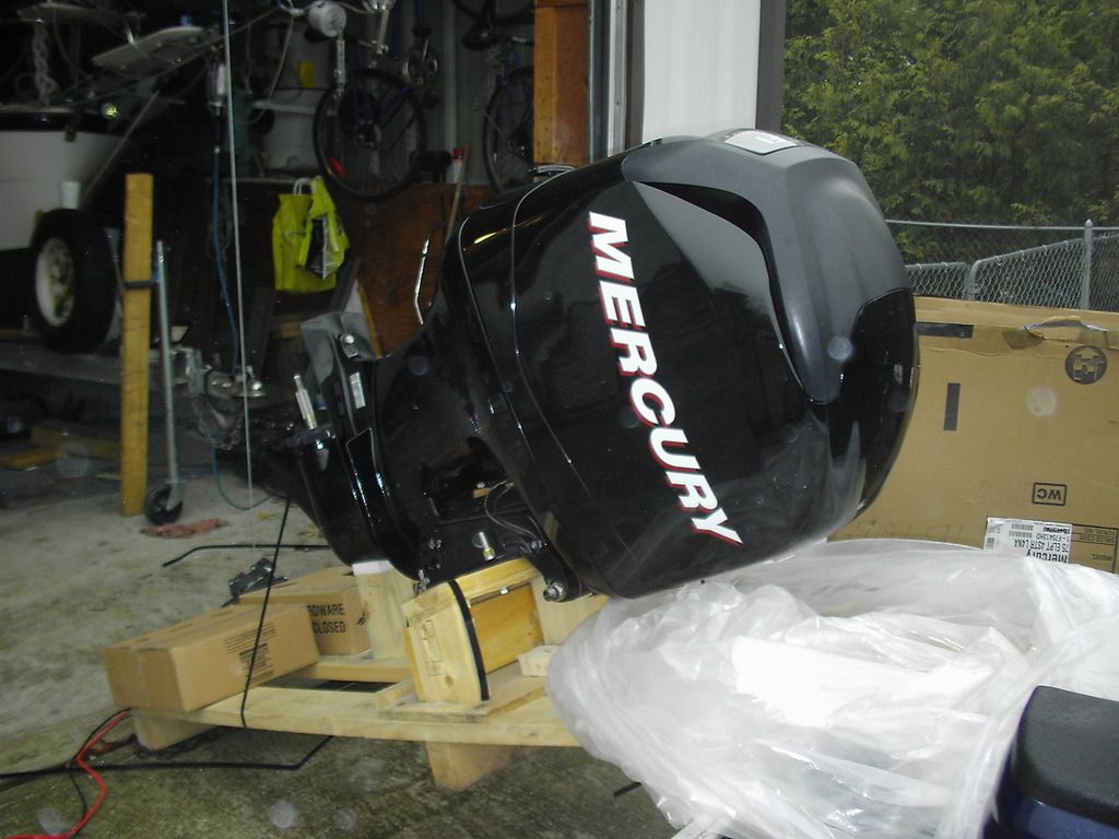

I bought my used 1yr old Merc 75HP 4 stroke from I-Boats for 1/3 thrd of it,s original new price had it shipped to me for $300. Can. & installed it my self :)
brought new boat home
http://i235.photobucket.com/albums/ee20 ... 010021.jpg
Bought the outboard had it delivered from BC to ON. picked it up at the transport location brought it home
http://i235.photobucket.com/albums/ee20 ... il842t.jpg
Unloaded it checked it all out was just like brand new as u can see in these pic,s
http://i235.photobucket.com/albums/ee20 ... j1u0vc.jpg
http://i235.photobucket.com/albums/ee20 ... 9wsw72.jpg
http://i235.photobucket.com/albums/ee20 ... k0ddh1.jpg
http://i235.photobucket.com/albums/ee20 ... dzzbvu.jpg
Installed with wedge kit
http://i235.photobucket.com/albums/ee20 ... 010070.jpg
http://i235.photobucket.com/albums/ee20 ... 010072.jpg
Easy peassy :P
