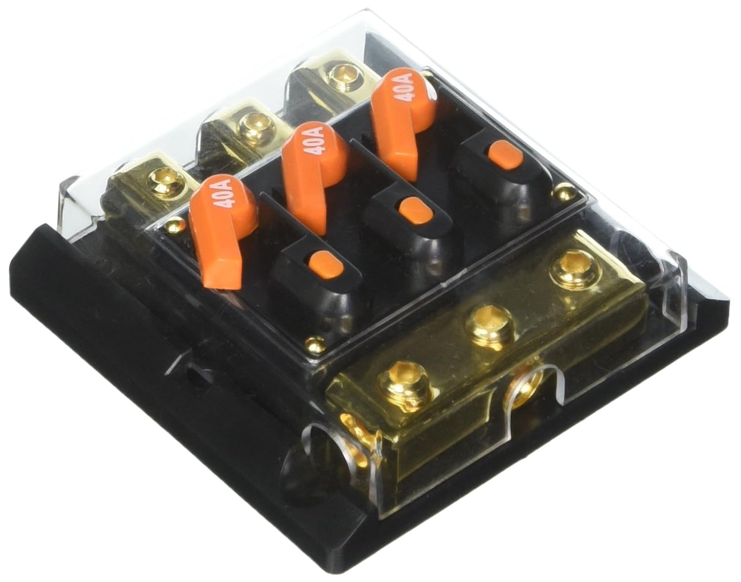

The blue seas terminal fuses are clean way to do things.
These are a fairly cheap and easy way to protect a few runs coming out of a battery and work as a disconnect too. Come in a couple sizes/configurations.
https://www.amazon.com/PLDS30-Triple-Li ... B0007LCM9Y
