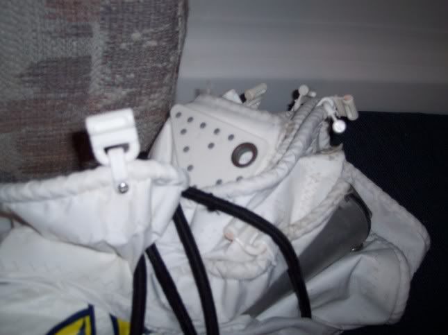

This is probably the cheapest and easiest slug to install. All those others look really good and I am sure are better. Not looking to argue. These too are from Sailrite. I let the screws pilot their way thru the sail cloth. After 3 years of aggressive sailing, I can't spot any problems. I wanted to do it myself so the placement of the slugs would allow me to reef the main without having to remove any slugs from the track. They work.
[img][img]http://img.photobucket.com/albums/v700/ ... regorX.jpg[/img][/img]

Mine look exactly like Billy's.
Here's what I did, copied from an earlier post:
As far as knowing where to start at the top, I think I installed one just at the bottom of the headboard.
As for knowing where to start at the bottom, just mark a point a couple inches above where the slot widens to leave room for a stop. Alternatively, you can just guess and leave that bottom one loose, until you do your final fit on the boat...
The processed described, was my very first attempt at anything like this. All you need are the slugs, plastic shackles, a phillips screwdriver and just a little confidence in your own abilities... You'll get much improved sail handling and a significant sense of satisfaction...
DLT wrote:There is a post that talks about the spacing. But, what I did was simply install the slugs every two feet coming from the top, until I got close to the reef cringle. Then, I installed a few slugs coming up from the bottom (actually, you'll want to start several inches up from the bottom of the sail in order to get that bottom slug well into the track), until I got close to the cringle. I did this with the sail laid out on the ground.
I also "placed" a couple of slugs and shakles on the sail, but didn't "install" them, i.e. I didn't screw them together, so that they could slide along the sail.
Then, I moved to the boat and hoisted the sail. I played with the position of the "loose" slugs until I was able to reef without dropping any out of the track while minimizing the gap between the slugs around the cringle.
I did install two slugs a few inches apart, both top and bottom of this cringle gap, just to better distribute that load...
