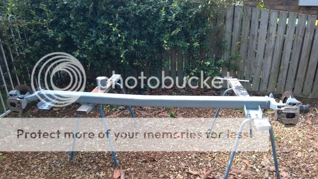

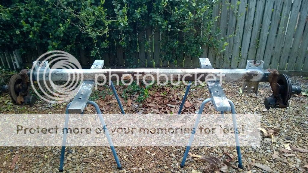

Below is some pics of my restore, hope to get another 18-24 months out of it.

- kadet
- Posts: 1030
Re: Trailer Mods required overseas
Sorry Neo I have been away for awhile and just saw your post.Neo wrote: ↑Fri Jun 21, 2019 4:07 amDid you grind it back? ... Which treatments/paints did you apply?
I'm considering finishing the axles with that Black Tar stuff called Body Deadener. I've used it before with great results but not in salt water before. https://www.supercheapauto.com.au/p/sep ... /3185.html
This is a great tip (that I should have remembered) ... Thanks
Trojan don't appear to do Axles... or am I missing something?
I have found one Axle manufacture in Brisbane that claim they can do 50mm Overlay (drop) axle but won't stamp that on the Axle but will put it on the invoice. In NSW I have to get an Engineers report just to get may trailer rated from 1,905Kg to 2,000Kg!! And if I go back to back to a single axle (much prefer tandem but daft ADR's) I might be able to avoid upgrading my tow car too.![]()
Yes I stripped it back, wire wheel and sand blasted it. Coated in cold galv then used bituminous black underbody rust preventative similar to the septone stuff you mention I suspect.
