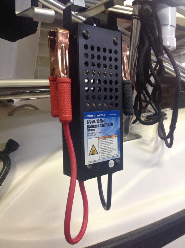

Post by Inquisitor » Wed Dec 23, 2020 10:32 am
I took the battery down to our Advance Auto to check out my options for a replacement. He checked out my battery on his device that probably does the same kind of thing as your all's gizmo.
Reading
Voltage: 12.73 v
Rated CCA: 550
Measured CCA: 580
Temperature: 63F
He said if I were to get a brand new battery of this rating, it might measure as high as this one. He looked at the tag on the side (8/2013) and called over all the other guys in the place... customers and workers (small town everyone knows everyone else) "Come and look at this guy's battery. You ever see one this strong and this old?" Most of the responding dialect I wouldn't know how to spell. And this is Bass fisherman's country... These people torture starter and deep-cycles batteries for fun.
The recommended starter battery for my Merc 60 is 330 CCA.

After researching @ris' find about mixing batteries viewtopic.php?f=9&t=28110 I had to check out my deep-cycle-marine battery that I've been testing as part of this thread. In that video, Clark stated that the lead-acid battery must not draw too much current while in trickle charge mode. He stated 1/4 amp was consider OK and 5 amps was bad. My battery draws only 60 mA once at the 13.2 volts trickle voltage.
Also, I'd be interested if anyone that understands the lead-acid chemistry going on in these batteries might be able to explain why this abused, seven year old battery still registers better than its rated CCA and has this phenomenally low trickle current value, yet has such a dismal capacity test of about 1/2 of its manufactures rating. The test with Advance Auto's loading battery tester gave it stellar marks. I suspect the load bank tester we've been discussing would also pass this battery. This is rather discouraging as the "quick/easy" tests would give one a false sense of security about their battery health. Yet it will fall on its face once I expect it to give me even 1/2 of its rated 80 amp-hour value. Only doing the multi-day drain test found this.
