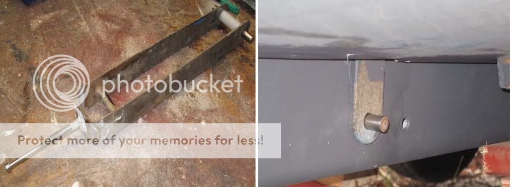

Ck to see if the head is split, a few have as mine did. You may want to consider a all braided line instead of wire to rope. If you go this route have a line spliced with a 3/8 inch eye. this prevents hangups in the trunk were the wire wore a deep grouve in the trunk due to the fastner and had to be filled and gelcoated. Amsteel line is braid is very strong and holds up well.
