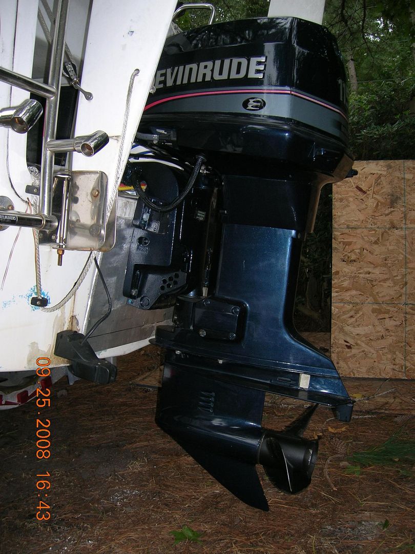

You forgot about this :macx: . . .
7 years, 600+ hrs., no stress cracks and still running strong (35 mph @ 3 mpg or 8mph @ 6+ mpg). Of course I used about 15 lbs. of aluminum plates.

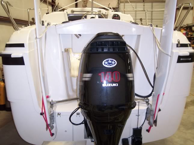

And there's a M in Alaska(?) with a 140. Don't forget Mark who had a 115 Suzuki--that now resides in NC. So the Mac can handle the horsepower, the question is can you handle no warranty. :wink:
