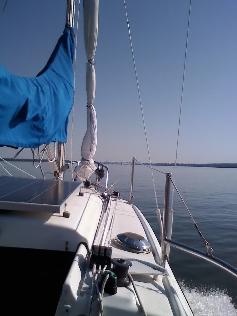

Mine's on the deck, just ahead of the sliding hatch on the starboard side. Inside, that's sort of above the forward galley seat. As it is at a high point in the salon it's a good location to remove the most heated air from the cabin.

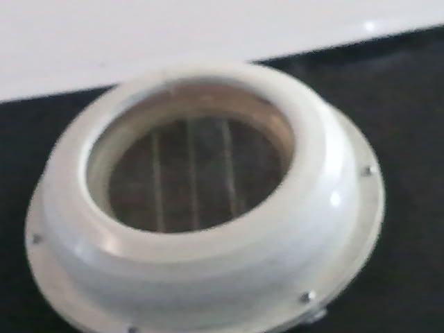

I made two mistakes with my solar vent. First, I got cheap and bought an inexpensive vent off of ebay--at a very affordable price. Second, it is cheap plastic with no battery or capacitor to store electricity for dark hours when we are indeed in the cabin.
Perhaps a third mistake was mounting it on the forward hatch itself. My wife and son opened the hatch on more than one occasion and dropped the hatch the last inches to the deck.
The plastic lens first cracked and later shattered/fell out. I've got to replace it but am considering a steel Nicro mounted on deck. I like the idea of a vent over the galley too.
Sorry about the poor quality of the pictures.
