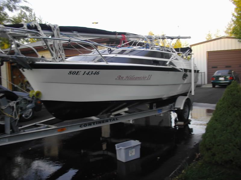

Well I have antifouling on the bottom of my hull after about 10wks took her out squeaky clean
no water line marks on the s/b side

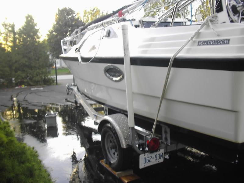

front p/s side clean PS notice how my trl's long tongue accomodates my sweet looking bowsprit :)
aft p/s side this is the slip side not so clean
stern

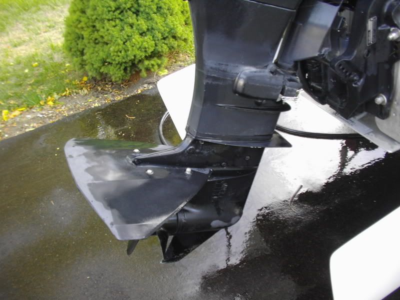

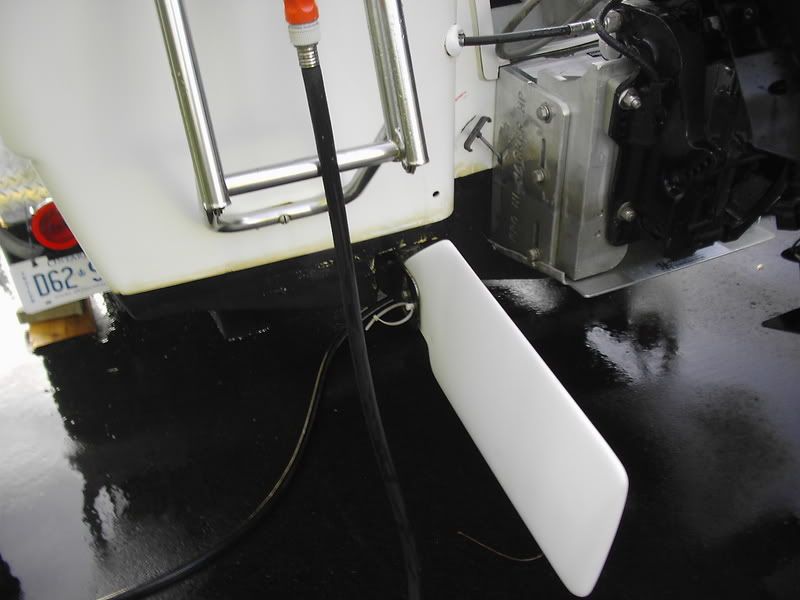

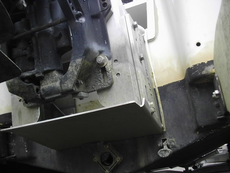

Well works ok on the hull water line I used a sponge scouring pad, first I wet the hull down, then I used full strength, then I used mixed with hot water, I had to do it a couple of times & rinse off often it did take some of the shine off the hull above the water line, it did not take the hard core stuff off about 1/4" to 1/2" above the water line I'll have to see if theirs something esle I can use
It cleaned up the eng. & rudder nice
Here I cleaned off the port side hull aft section you can really see the diff.

Isn't the Macgregor label above the rubrail? ... how'd your boat get so ugly up around there?
