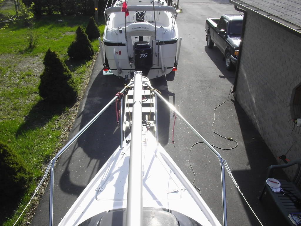

Hi Highlander I am sure interested in a couple closer photos of your bowsprit it looks real interesting, a lot like I was thinking of making. How long is it from your bow?
I didn't understand your rolled up spiniker please explaine further. Can you fly your A spinniker sailing solo from the cockpit?
- Posts: 5995
Did you not notice that when I was shooting the video of the spin I was sitting on the bowsprit seat & their was nobody on board steering the boat !bubba wrote:Hi Highlander I am sure interested in a couple closer photos of your bowsprit it looks real interesting, a lot like I was thinking of making. How long is it from your bow?
here is my 4ft bowsprit on my mac19 all sails are controlled from the cockpit three diff furlers storm sail on hanks
you can view all my mods on my photobucket sites
at albums maccutter19 and maccutter26m
the mac 19 bowsprit is 4ft the mac26m bowsprit is 4ft for genny with a 2ft pull-out extension making it 6ft for spin. it is still in the making I hope to get it finnished before the end of june !!
The spin is mounted to a CDI Spin Furler you can check out the CDI site for more info they are not cheep $
