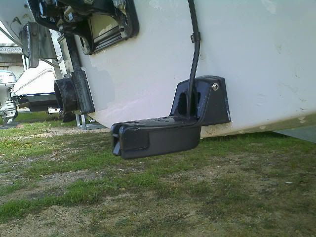

I have an Airmar P58 transom-triducer mounted on the starboard of my
just under the boarding ladder. It's depth and temperature functions work great in that location. The log speed function also works very well when under sail or moderate power (up to about 8knots), but at WOT it picks up prop effects and indicates crazy speed (33 knots when the GPS tells me I'm making 14 knots).
