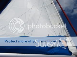

I'd like to respond to Bluecrab's comment about sail performance.
Our charter boat had a big Doyle sail caddy, shown here with only one reef.
That's gotta cut down on sail to wind exposure, whatever it's called...
which was fine when you're livin' on the water for a week. I wouldn't want it interfering with day sailing though.
Our Mac with it's new KH C-2000 sails is far more frisky than that Beneteau. I was kind of disappointed in
it's sailing performance but don't know if it was due to blown out sails, the sail caddy, or simply our own lack
of skill.
of skill.
