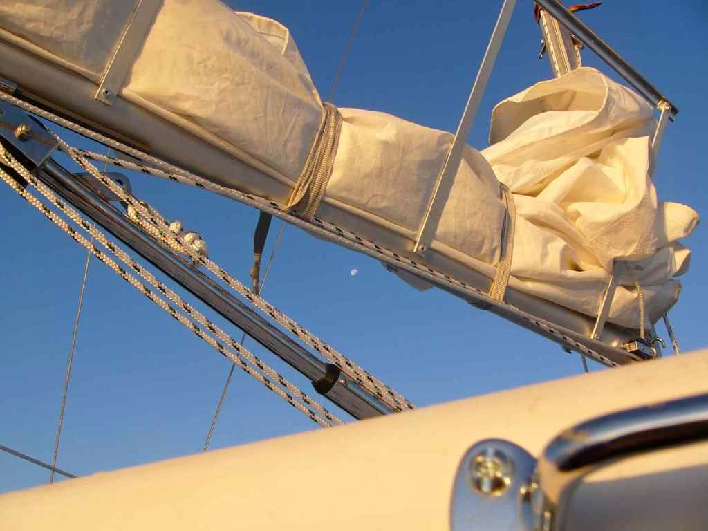

Here you go:

I like it :-)

Looks good Patrick, I like the simplicity of the cradle, anything to shorten setup time at the ramp is good.

PatrickS wrote:I made my own sail caddy based on the commercial product http://www.sailcaddy.com/ and love it....
After checking that URL, seeing their info, then seeing Patrick's photos of his homebuilt "sail caddy", I am quite impressed with Patrick's work! (Meaning, I know I couldn't do near as well as Patrick did, so I had better order one from SailCaddy.)
I haven't been satisfied with the Harken lazy-jack setup that was installed for Bossa Nova's previous owner, and (sorry, Art!) the idea of installing Doyle's idea of lazyjacks put me off on the Cradle Cover. I was figure-figuring on how I might design and make my own "cradle-cover" this morning, with a simplified lazy-jack notion of my own. But this looks quicker, simpler, safer and all-around better, and I can see it won't interfere with my present cover.
Thanks, Patrick!
The construction overall is pretty simple, and the parts easily available from your local hardware store of choice, but it's a case where the old adage "measure twice, cut once" applies (or in fact, "measure 10 times..." ;-)
Because you have so many hinge points that must be aligned near perfectly, being off by a few mm on any given hole (or worse, a couple holes) really screws things up quickly (I actually made two caddys ;-)
But so long as you realize the importance of how precise the measurements have to be, and take the time to measure carefully, it's actually very easy to build (I know that might sound like a contradiction, but I don't think it really is).
That said, I can fully appreciate ordering the commercial product. For me, it was as much about having the time and being keen on the project as it was wanting to save some scratch.
Patrick

PatrickS wrote: The construction overall is pretty simple ... That said, I can fully appreciate ordering the commercial product. For me, it was as much about having the time and being keen on the project as it was wanting to save some scratch.
Well, I went ahead and got the "SailCaddy 8", and installed it on Bossa Nova. I didn't manage a perfect installation, but it worked quite decently when I put the mainsail back on the boom.
You are absolutely right about "measure twice ... actually ten times." I did that, but even so I had some slightly-out-of-line mounts, which I attribute to not having bothered to center-punch before I drilled the boom. Another problem was that SailCaddy recommended a drill too large for mounting the blocks - so I had to drill another set of holes, and mount the SailCaddy about 3/8 inch farther aft of my original installation.
Went sailing with it Saturday, into some "interesting" Chesapeake Bay winds ... it doesn't hamper either deploying or dowsing the main, at all. It gives me a nice "tray" to get the sail flaked down decently, and then it fits right under the sail cover.
