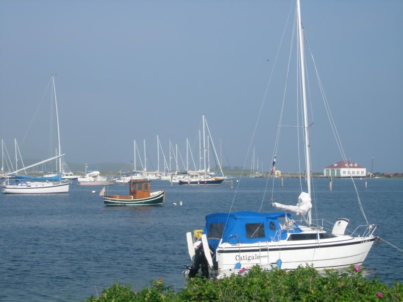

I also have the Dowsar full enclosure with the wide dodger on my :macm: here are a coupleof pic's I'll try & post some more later today if I get the time & it does not rain me out from working on the boat again I think the last time I seen this much rain was back in Scotland !!! :D
http://i235.photobucket.com/albums/ee20 ... 010117.jpg
http://i235.photobucket.com/albums/ee20 ... 010110.jpg
As you can see I sail cutter rigged & have no issues with winches or lines , the extra wide dodger is no problem to step around to get up on the deck , most guys have their powerclutches attached there so you always have to step over them also so it is no big deal I plan on installing my clutches inside the dodger

The dodger in the Kelly Hanson East pictures is the one that used to be made and sold by Havencraft. I don't believe it is still on the market. It is the dodger that is so wide that you have to unzip a side window to gain a place to step when going forward.
As you can see on both my X pictures and Highlanders M pictures, the Dowsar wide (outside the winches) dodger still gives you just enough deck space to easily walk forward yet fully protects the cockpit, particularly the X version. Our dogs also find the space sufficient and make the walk alongside it to the bow with no help or difficulty. The Dowsar M version is not as deep as the X version because of the traveler, but it's nice to see a wide dodger on an M. All the BWY dodgers for the M's are narrow (inside the winches).

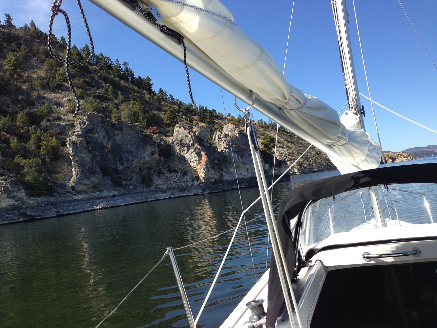

Yea Doug,
We took it off for one season. Next season I put it back on and now really appreciate the dodger.
I find it's easy to grab onto going up on deck. I even bought the clear "door" panel from BWY that allows us to have a glass "door" and close up the cabin and still stand up fully.
Also, I bought the connector between the dodger and bimini to make one big panel when it's raining and we can keep the cabin open and go into the cockpit. It's not 100% dry like full enclosure, but it keeps it mostly dry for the captain seat.
Really like the dodger. The glass does get spray and need cleaning a bit. But it does also help keep rain and stuff from coming into the cabin and still have it open.
