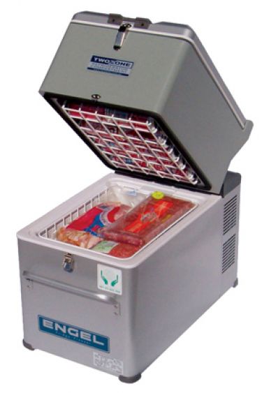

On Little Rascal (1983 Mac 25), We also have an Engle 35, powered by 2 Optima "YellowTop" batteries, charged by a 55 amp alternator mounted on top of our 9.9 Evinrude Outboard fueled by twin 6 gal tanks. We call it "Mr. Fusion".
We are never out of power, but one fully charged yellowtop runs the fridge for a full day with some left over. With full fuel tanks we can cruise for days without having to go ashore. Little Rascal out!

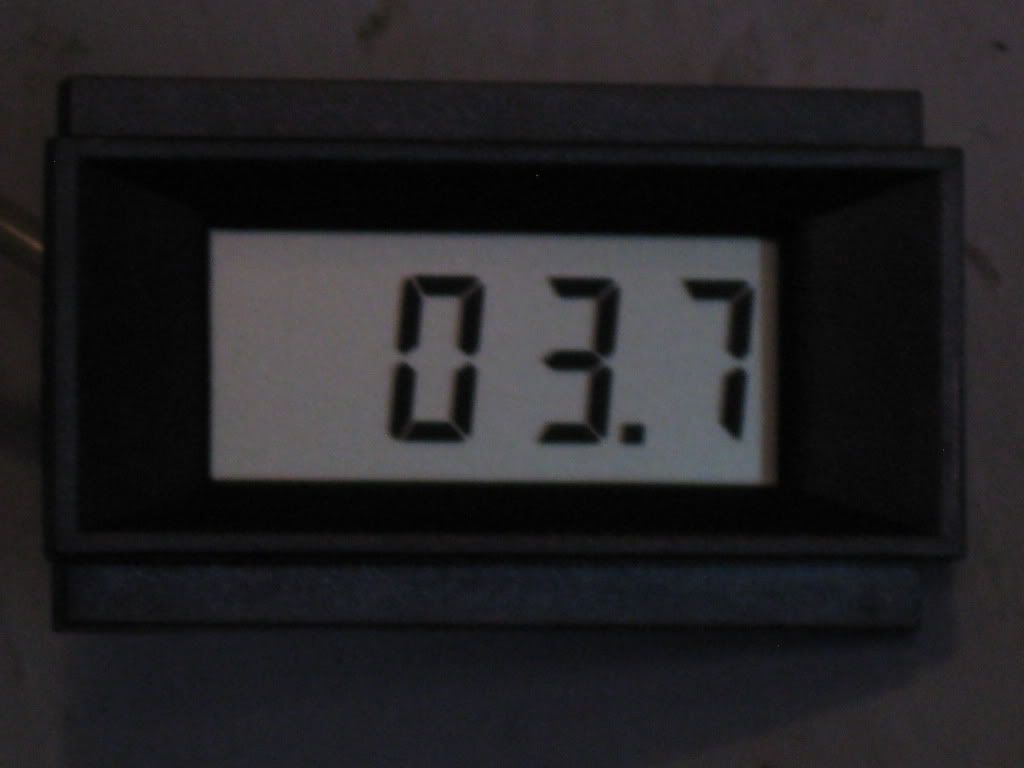

Okay, I hooked up my new digital Ammeter to my Edgestar fridge.
I'm not sure how accurate it is because with zero load it read .2 amps. Still, this looks pretty good.

RussMT wrote:.......with zero load it read .2 amps.....
Hey there is a lot of electricity in the air in Montana 8) . My hair, back when I had some, was standing straight out once on a mountain top outside of Bozeman in a storm :o .
Whose meter is that? From SolarBlvd.com? Mine looks like that. I was surprised when it came an you had to hook it up on the negative side.
So you're saying the EdgeStar was pulling maybe 3.5 amps with the compressor running? I'm impressed with the insulation in them. I started ours 3-4 weeks ago in the boat which was in the shop and took it down to about 38 degrees and then turned it off. I looked yesterday and it was still 45 deg. inside of it and the shop has been 53 deg or warmer all of this time. I'm anxious to see how it works this summer,
