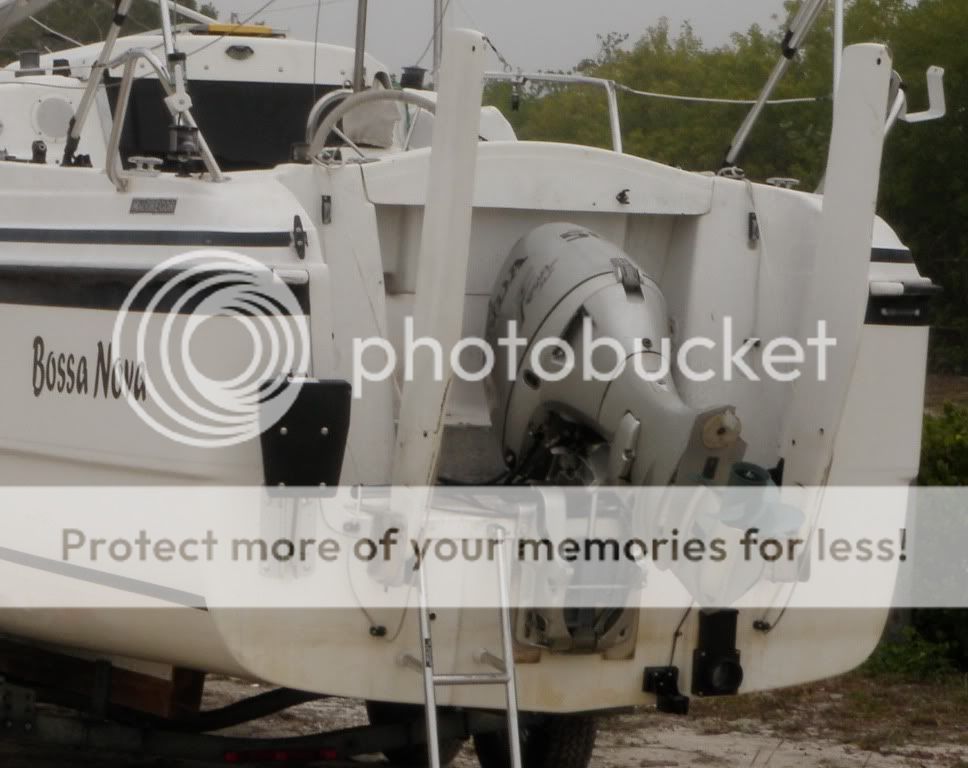

I put a Panther lift-up aluminum outboard bracket on Bossa Nova, on the port side of the stern just outboard of the rudder. It was an awkward job, as there isn't much room to spin a wrench up inside the transom; I also had to cut away enough of a fiberglass fillet in the stern to make room for the backing plates. And I got it a couple of inches too low, so the dinghy-kicker's prop does get wet on a starboard tack. Oh well, I did my best on it.
The engine I got cost less than the bracket; it's a 1959 Evinrude Lightwin, 3-hp two-stroke, that I picked up for $100 on Craigslist. I did all of this in November, and I haven't had the dinghy out since I installed the bracket. I did take Bossa Nova down to Florida in early December, which is how I know the engine drags with the mount full "up"; but it was cold enough that I chose not to mess with the dink, and I spent my nights in a marina instead.

Rick,Rick Westlake wrote:I put a Panther lift-up aluminum outboard bracket on Bossa Nova, on the port side of the stern just outboard of the rudder. It was an awkward job, as there isn't much room to spin a wrench up inside the transom; I also had to cut away enough of a fiberglass fillet in the stern to make room for the backing plates. And I got it a couple of inches too low, so the dinghy-kicker's prop does get wet on a starboard tack. Oh well, I did my best on it.
I have seen the Aux motor mounted on both the port and starboard sides. Why did you choose the port side?
Bob

Bob,RJG 26S wrote:Rick,
Bob
I chose the port side because it's next to the boarding ladder. It's my habit to board the dinghy from there, and I cleat its painter to the port quarter cleat when I have it in the water. Also, I have a cleat on the port side of the stern for my topping lift, and when I do move the motor to the dinghy's transom I'll be able to leash the motor to that cleat while it's unclamped.
I might have put my motor on the starboard side, if I'd remembered that was where Chinook put his mount.
