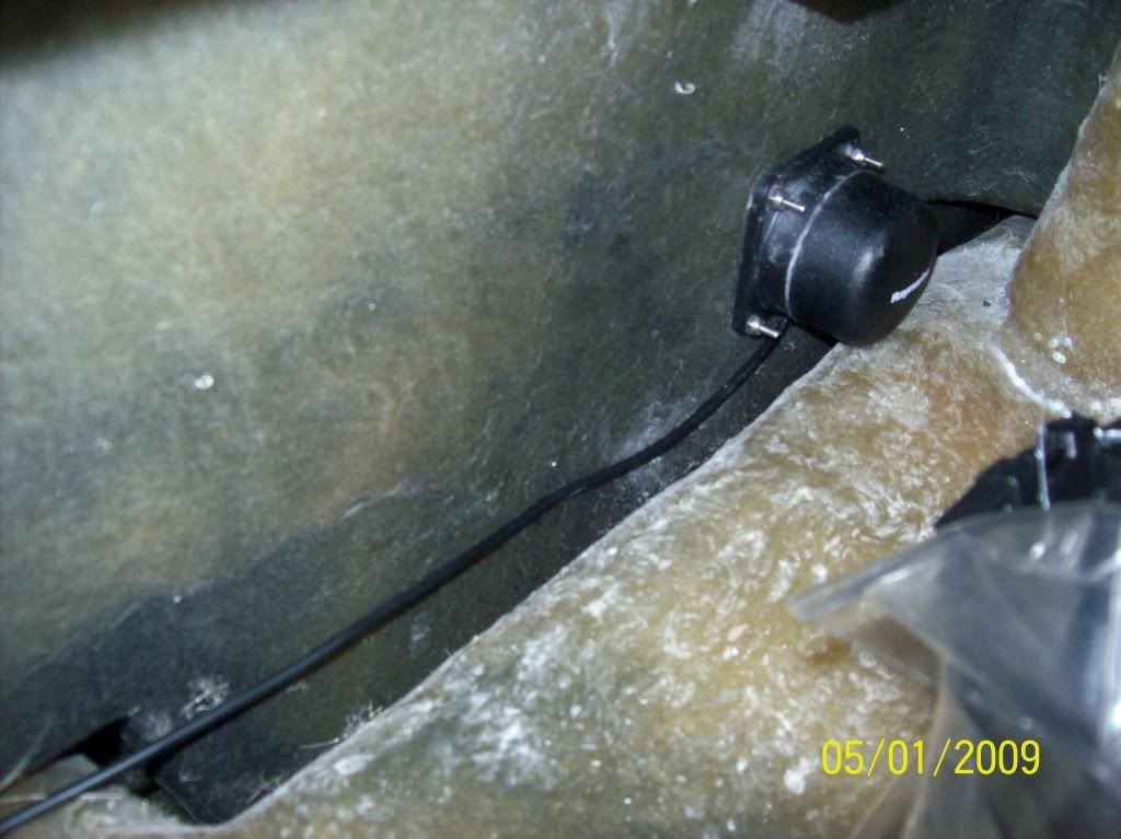

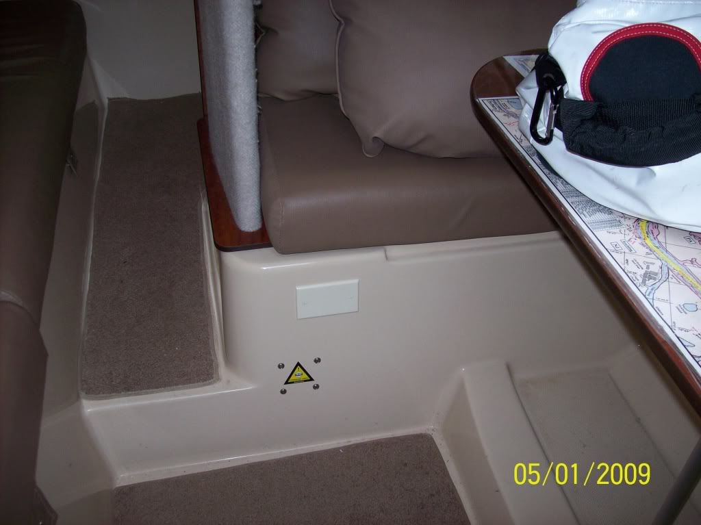

Irafatsar,
I installed my FluxGate compass near that site but not quite. It is mounted in the back corner of that seat area, right up against the dagger board housing and above the seat deck. It does not interfere with the seat cushion or the hatch that covers that compartment below the seat. Works like a champ. Got the idea from Delevi who used to haunt these grounds but haven't seen him around in a while. He sold his Mac and got a bigger boat.
