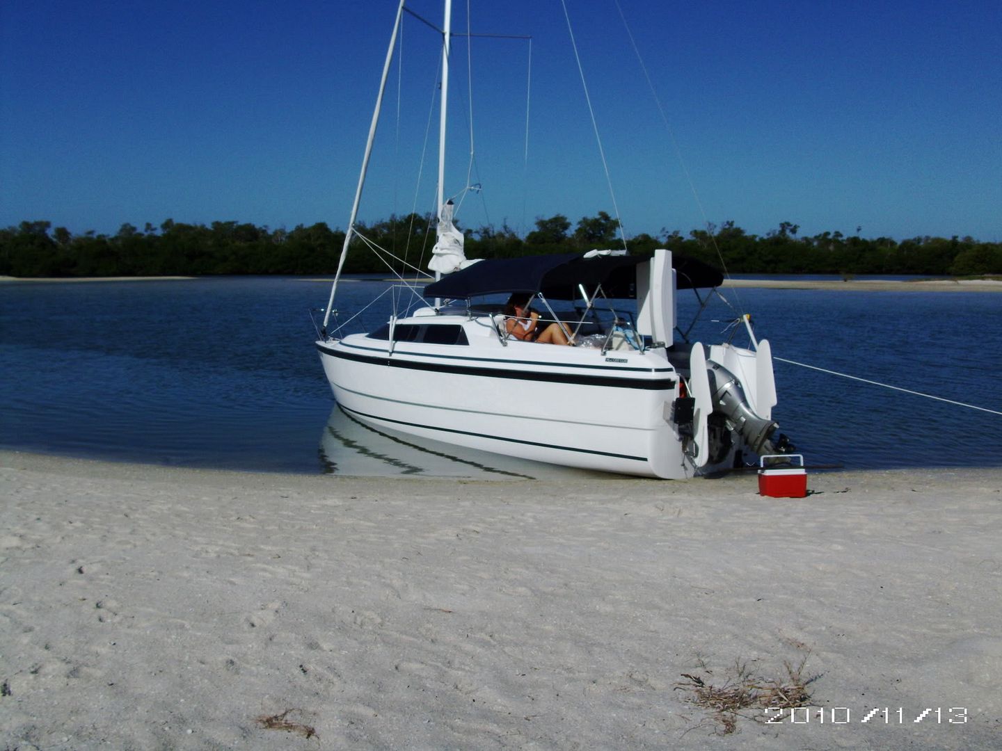

Here is a photo of my bracket without outboard, my outboard with 15 inch shaft clears the water by 4 inches and just hits on a 15 degree heel.
http://i182.photobucket.com/albums/x25/ ... CT0325.jpg
The Mac.X does not have enough room to mount anything larger than the Nissan and it is very difficult mounting the bracket as there is no access to inside transem for putting your nuts on bolts and have to drill a 1-1/2 inch hole at transem centered at middle of bracket and another one at side as there is a fiberglass wall you need to go thru to reach the inner bolts with a very thin needle noze lock plyers to hold the nuts. Very time consumeing and a lot of patiance.
You put a plastic cover over the holes sealed with 3m 4200, these covers can be bought at Blue waters.
