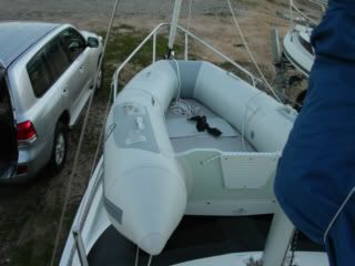

We would like to carry a tender on the boat that will be ready to be inflated when we need it and also would like to store it on the foredeck if possible. Ideally the tender would carry 3 adults but I think I could accept the compromise of 2 adults. Also I would be open to using a canoe and i would prefer not to use our outboard as it is one more thing to use up space on the boat and stink of petrol.
I have seen a picture here of a 2.4m tender on a 26M here which is very encouraging.
My concerns about this arrangement is that it looks like it will restrict access to the fore deck cleats, fore hatch opening and anchor, and also that it may interfere with the jib. We have a 150 furling jib so thinking out loud we may be able to sail on a limited amount of jib.

I've experimented with using a canoe as a tender, with poor results. The canoe in my case was a 17 foot aluminum canoe which we trailed. It trailed very poorly. It's narrow beam made it impossible to rig a bridle, and the canoe tended to swing back and forth excessively. When outside the wake, which was often, it easily took on water. Also, when at anchor the canoe kept wanting to bump into the Mac. Regarding inflatables, we have a 9.5 foot model sold by West Marine, made by Zodiac. It features a high pressure floor, which makes it easy to pump up while sitting on the foredeck. If we're traveling on relatively protected waters we trail it. It tracks and trails very well. If we're making a passage on exposed waters where I want it stowed, I carry it, deflated, in its storage bag. It stores easily on the foredeck, deflated, or can also be stored below. Since it has the inflated keel and floor, it's easy to pump up while standing on the foredeck. I wouldn't want to try carrying it on the foredeck while inflated, since it would tend to obstruct forward visibility while underway.

We have been using a West Marine RU360 (roll up) with acceptable results. It is rated for three people and a 4HP engine. We can inflate it on the foredeck. It fits on the fore deck once inflated but blocks vision from the helm. It tows well behind our 26M. When deflated and stowed it fits in the cabin. We forgot to bring it with us on our last trip to the FL Keys and had to purchase another while down there. I don't need two. Please let me know if you would be interested in it.

We really like our Saturn Kaboat. It seats two very comfortably but we have done it with 4. I would not want to do any more than boat to shore if I had 4. We use a 2hp Island Hopper 4 stroke to push it and have not had any problems. It also paddles well since it has four 5 inch hard rubber fins on the bottom. This helps it track better. We lost the oars overboard (too much fun at the Key Largo Stone Crab festival) and have replaced them with Kayak paddles $16 each. We really like the Kayak paddles. I drilled a whole in one paddle to put it in the built in paddle holder on the boat and bungee the other ends together.
It inflates easily and can be stored upside down on the forward deck but I don't like it there. I only put it there when I launch the boat. At other times it tows very well or can be pulled up along side the Mac and tied to the winch to keep nothing but the stern in the water. We have also hung it off the lifelines and stanchions but that was a pain.
