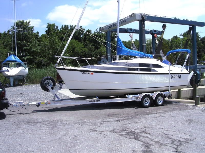

Dimitri - Jim (c130king) got a new trailer which I drooled over the other week...about 3 boat bucks like the others, but the quality of construction etc was top notch. Pm or EM of course.

Dimitri,
Several of us here in the DC/Baltimore area got dual-axle Loadrite Trailers. Big difference in the "beefiness" between the old steel trailer and the new aluminum. And it is 400 pounds heavier (1100 vs 700).
I am very happy with it and will get it on the road for it's first real road trip (700 miles) next week. So far it has only done 25 miles empty from trailer store to marina (mast up storage) and then I trailered the boat about 65 miles back to my house.
Aluminum main beams with galvanized cross pieces, everything is easily adjustable, big beefy winch, big beefy hitch/brake mechanism, brakes on front axle only (option for back axle also), all LED lights.
VERY HAPPY with my new trailer.

Hi Jim, that is a great looking trailer, congratulations! Loadrite doesn't seem to deal in Florida so I've been focusing on local dealers and manufacturers since there happen to be a lot of them in this neck of the woods. What I'm doing is looking at these nice trailers like Loadrite which you guys (owners) are happy with, and then making sure that I get the same type of trailer built locally. That should save me a few hundred bucks and I will have a local place in case I need any support. So far, from what I can tell, Continental, Loadmaster, and Ace trailers all seem to have that big beefy Aluminum I-Beam construction like the LoadRite does. But I'm also still toying around with the length and width issues. Certainly, getting a longer trailer than the original Mac trailer makes good sense for multiple reasons. Also, if the boat sits higher on the bunks, you need the longer tongue to compensate for that and make sure you don't have to dunk your tow vehicle. But what I'm not sure about is the width. The stock Mac trailer is about 95-96 inches wide where as these beefier tandems are about 102-104 inches wide which is going to make it more difficult for me to put the boat besides my house where I have a narrow alley. Do you think that extra 7-8 inches of width is important seeing as the trailer is already so much better than the original?
And with these bigger trailers, comes more weight as you have pointed out. Maybe good from a stability point of view but it probably burns more gas and also decreases the payload (ie. if my SUV tows 6000 lbs, then that is 400lbs less boat I can pull). So, I'm trying to resist the need to just buy the biggest honkin trailer I can find due to that as well. Clearly, in addition to braun, the quality of the components which go in the water is extremely important. Ie, I don't want to have to buy another trailer in 10-15 years because everything rusted out from the salt water exposure.
