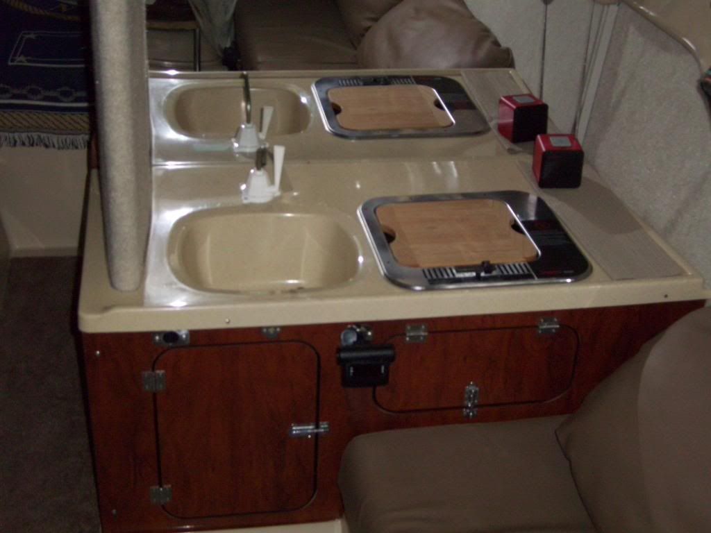

c130king wrote:Frank/Ray,
How did you run the power to the spot above the mirror? Did you have to cross it over from the other side?
Jim,
My Perko switch is located on the Starboard side aft locker area, near the bottom of the cabin ladder. I ran the POWER wire (fused) forward through the starboard lockers through the sink/stove locker and by placing a square plastic conduit with the sticky side against mirror, it's hidden behind carpeted daggerboard enclosure in that small space between mirror and daggerboard, up to above sink area. You'll see the 2nd exact conduit ( aft speaker wire run in this photo) ... it's located in the corner, right behind red radio, and runs from top sink/stove area up to starboard fiberglass then aft to rear speaker. I used Valspar plastic paint (Lowe's) on both conduits with color that is almost exact to color of carpeting. Hope this helps.
Image (CLICK PHOTO TO ENLARGE)
One more thing, I fuse any add-ons w/Ground right to the back of the Perko switch with EZ access under the seat locker lid. It's a lot less PITA , unless you want to get real fancy and add another fuse panel, I chose to do it the EZ , but just as effective way... I get fuse connectors at Radio Shack.

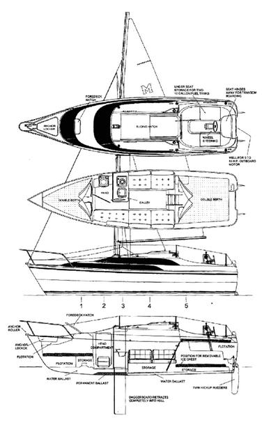

Sorry for my ignorance, but I see from these pics some :macm: boats had a galley at the mirror by the head. What years were these? Are there line drawings of this? It's an interesting layout for sure. was there a fold down table or something?
Now really off topic, does this possibly have anything to do with an M owner telling me that he'd have bought an :macx: " if I had known..." known what?
Sorry this is on the verge of a hijack.
Willy
Jim Bunnell
Posts: 278
Re: Marine Stereo Installation
Post by Jim Bunnell »
See thread http://www.macgregorsailors.com/forum/v ... =9&t=18366 for discussion of details and photos. Briefly 2003-2005, table inserted into slot below countertop - some variance in table year to year. Several differences between M and X - for my money the biggest is the "head room" in the head (X is taller). They are all compromises.
