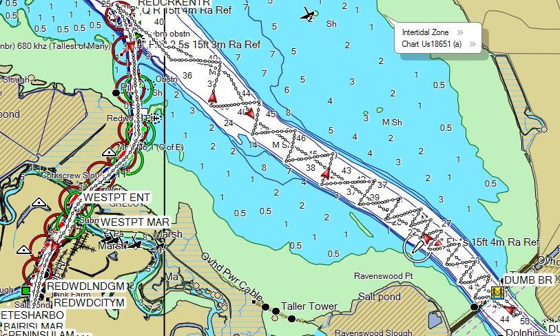

See GPS track below from a recent sail on SF Bay. All upwind tacks are close hauled. Looks like she tacks through about 60 degrees. Conditions were moderate chop (about 2 ft waves from an ebb tide), and wind 10-15 kts. Main was single reefed.Do you use GPS? If so, take note of your heading while sailing close hauled. Tack, and then note your heading. By counting the degrees and dividing by 2, you will get your ability to sail close to the wind. Post your results. It will be nowhere close to 25 degrees, and most likely closer to 50 or 55 degrees.
Note this is actual track, and not boat heading (sideslip included).
