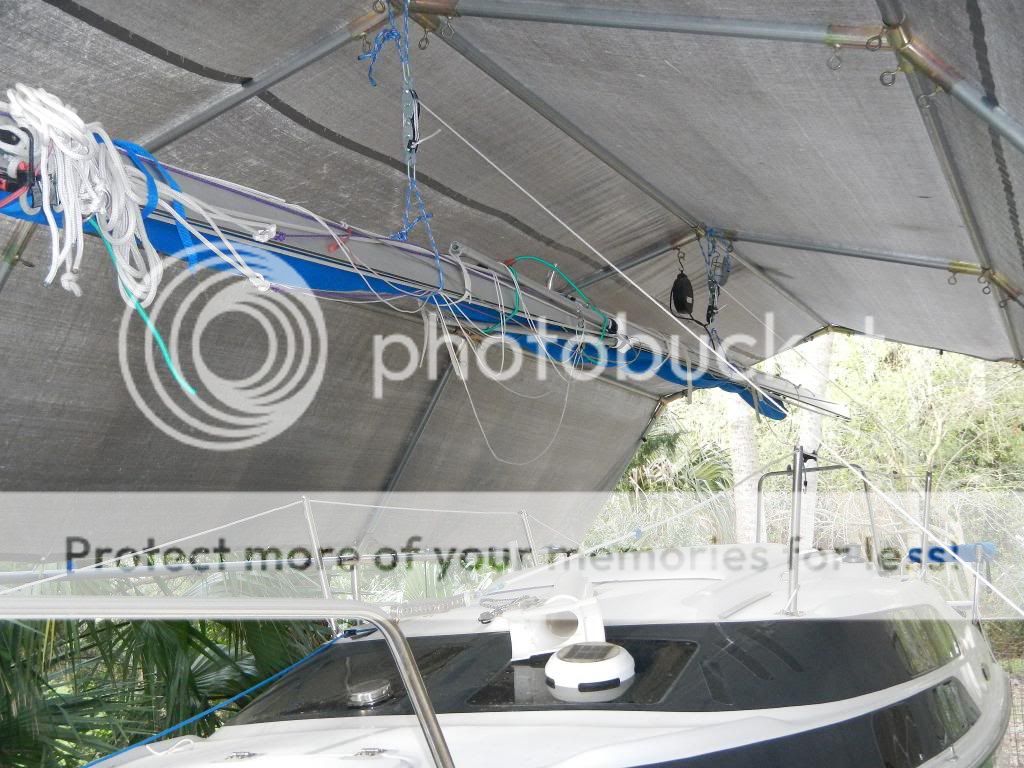

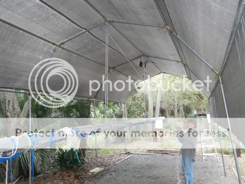

Update... Thought I would share with you my solution to removing the mast...
I bought 2 sets of $10 hoists from Northern Tool and Equipment each rated at 2000 lbs with a 7:1 ratio. Yes, a bit of an overkill.
Here's the hoist installed.
Next the Admiral and I hoisted the mast and jib/furler high enough the clear the mast crutch and I pulled the boat from under the mast
The Admiral was able to hold the mast herself
And then we lowered the mast to the ground on some wooden blocks, ready for our return.

I am so jealousfishheadbarandgrill wrote:Update... Thought I would share with you my solution to removing the mast...
Bob
Where you live
What you have to store it under
Your lifting system
Your mast support at the foot
Name it!!
You got it all going on...
Love it
Re: Motoring Without Mast
That's a great idea, and it gives me an idea for storing mine. I plan to do a bit of travelling to locations where we'll only motor (like for wakeboarding, or the Erie Canal), and the mast stored outside will get in the way. I'll likely leave it off for weeks at a time.fishheadbarandgrill wrote:Update... Thought I would share with you my solution to removing the mast...
My 2-car garage has one big door, and I could conceivably hoist the mast to the ceiling without getting in the way of anything, or fouling with the overhead door or tracks. A couple of cheap block and fall setups, and I'll be good to go. There's even room enough that I wouldn't have to fold the VHF antenna.
Thanks for the tip.
