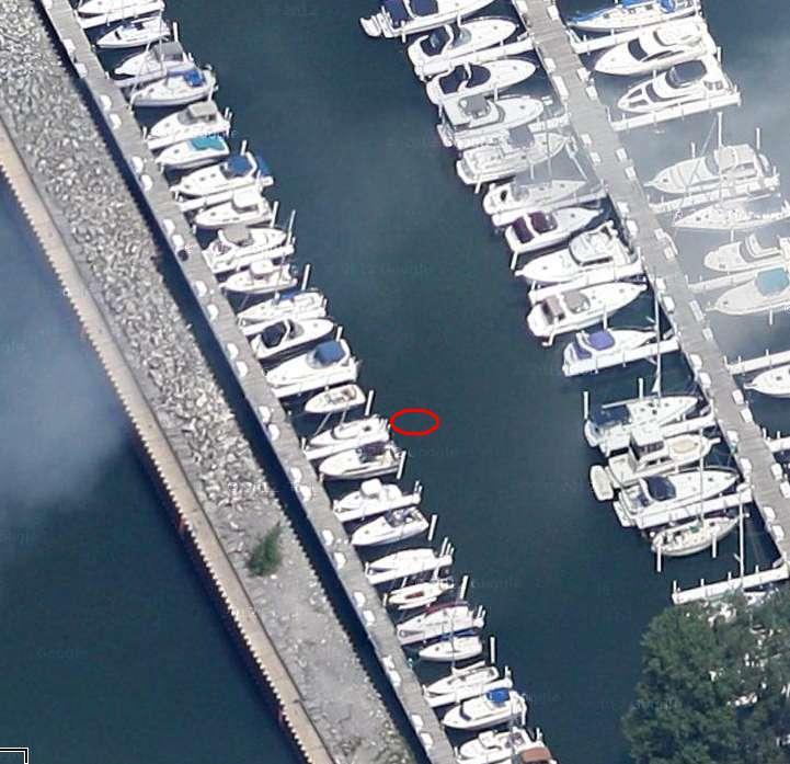

Do you moor your boat out on a bouy or do you actually use a dock? Seems access is not really an issue if there is dock in the vicinity.

I have a slip - and trust me - the dock is a fixed height and Lake Michigan is a bit lower than it used to be. 8)

You can simply rig the mast raising jin-pole on deck and use it to easily adjust stays even in the water, if you're at a floating dock. I've done it a number of times and in my opinion it's easier in the slip/water than on the trailer.
Just rig the gin-pole and get the mast under tension from it. Un-pin the forestay (can be done from the dock easily), and go back on deck to lower the mast a bit. If your baby stays are in place correctly rocking won't matter, and now your stays will be lose. From the dock, adjust the stays on one side and estimated about (figure 50 lbs. of tension per pin hole). Walk the boat to the opposite side of the slip and adjust the other side stays from the dock.
Once they're adjusted, tension up the gin-pole again and re-pin the forestay. It really is easier than adjusting them on the trailer or using the RAT.
The only thing you have to be careful about is not dropping a ring-ding or clevis pin in the drink. At a fixed dock, how easy it is depends on the water level.

Okay, thank you for the advice - and it's may be that you don't know the marina set-up in Michigan City. There's another sailboat on my starboard side tied up to ITS slip. 8) Pic shows powerboat, it's been changed to 22 foot sailboat. :D

Any chance of a temp slip or public dock you could use, maybe at a nearby ramp? I don't know, I just find adjusting way easier to do with the mast raising device and in the water.
