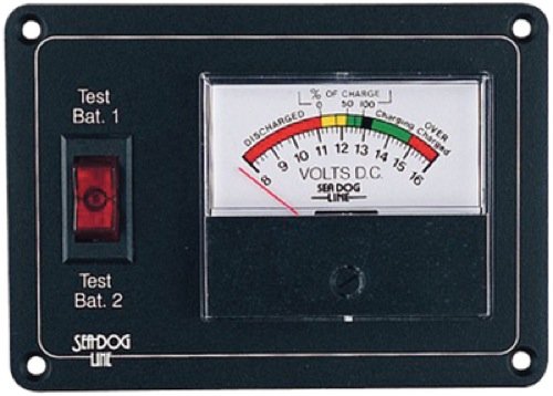

Just saw this - I've had good luck with my Sea Dog 422-010 fuse switch panels. A battery test panel looked kinda neat. 8)
http://www.sea-dog.com/groups/1947-batt ... ge-lighter
Input would be appreciated.

The voltmeter is only so useful and only as useful when it is accurate and then as a guide only, many arent and imho digital is better especially if it can be verified accurate you are dealing with fractions of a volt to be useful as a real test of battery draw down and charge etc.
As for the cigarette lighter socket I personally think those type of sockets except for some better ones should be kept only for their original purpose especially if you have different types elsewhere as all your specific voltage outlets should be the same unless maybe you want one dedicated for a specific purpose only.
Mind you it looks flash. :)
Hey DL -
The term battery “tester” is a misnomer for what this does. It would be more accurate to call it a battery voltage “checker”. A true battery tester will apply a load to measure the battery capacity. But maybe “tester” means “checker” in Chinese? Still, it is a way to get a rough estimate of the state of your batteries, better than nothing.
Putting the “horn” button there is a joke... maybe they're putting some bull by the horn :D :( .
A horn needs to be readily available. Abandoning the helm in an emergency to go below to the fuse panel to sound the horn is one ludicrous scenario, I'd say.
-B. :wink:

I looked at that Sea Dog panel when redoing all my electrical as well. After reading Nigel Calder and other things, comments from the above people and others, decided that panel battery indicator doesn't really help. By not knowing what the measure of red / green is and the various interpretations of good/bad are, I went with a Blue Sea Systems analog voltmeter.

Wife just got me this for my birthday. I always get boat parts for my birthday. Hooked it up last weekend and seems pretty nice. My fishfinder has voltage on it but it's not really accurate. It's a few tenths off probably due to the small gauge wire and run. I installed the battery test panel down on the galley close to the batteries to be as accurate as possible. I figure if I switch the battery at 50% while under a light load then it will be slightly higher once rested for a bit.
