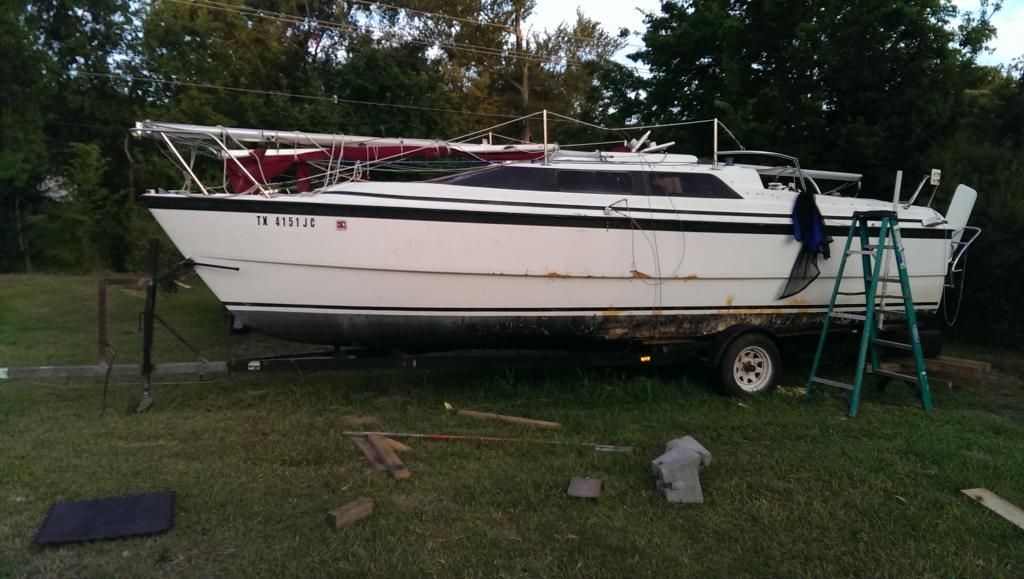

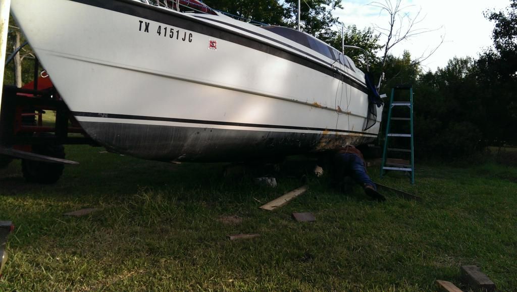

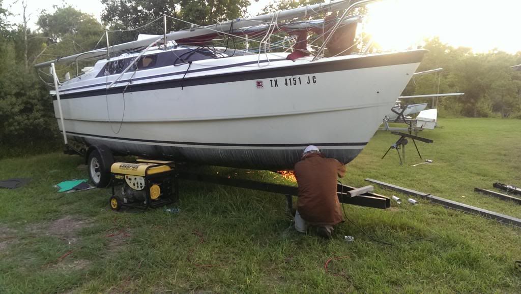

I'm Carl and my daughter is a part of Red Skies Sea Scout Ship 208 crew (see facebook). Our Ship was donated a 26x MacGregor about a month ago after the previous owner was caught up in a water spout at 5am on a Tuesday morning while camping in the boat in a small cut off the Houston Ship Channel. The boat was spun around a couple of times and dropped/slammed against some rocks (rocks stacked like a jeddi inside a small cove). The port side of the boat suffered significant damage, but we are hoping to repair it. The trailer like all original steel MacGregor trailers had a rusted out tongue and other issues. We've already fixed most of that and are about to turn our attention to repairing the boat.
The rigging all looked good when we picked up the boat except for one slightly bent spreader. It looks like all the damage is on the port side, mainly down at the bottom just as it curves from the side to the bottom. It looks to all be more than a foot away from the port side stringer, so I think the rigidity of the hull will be fine. Our Skipper is decent at fiberglass work and is going to do the repairs himself. The boat is currently dry docked at his sister's house right here in my neighborhood.
Anyways on with some pictures...

PIcs of outside...
