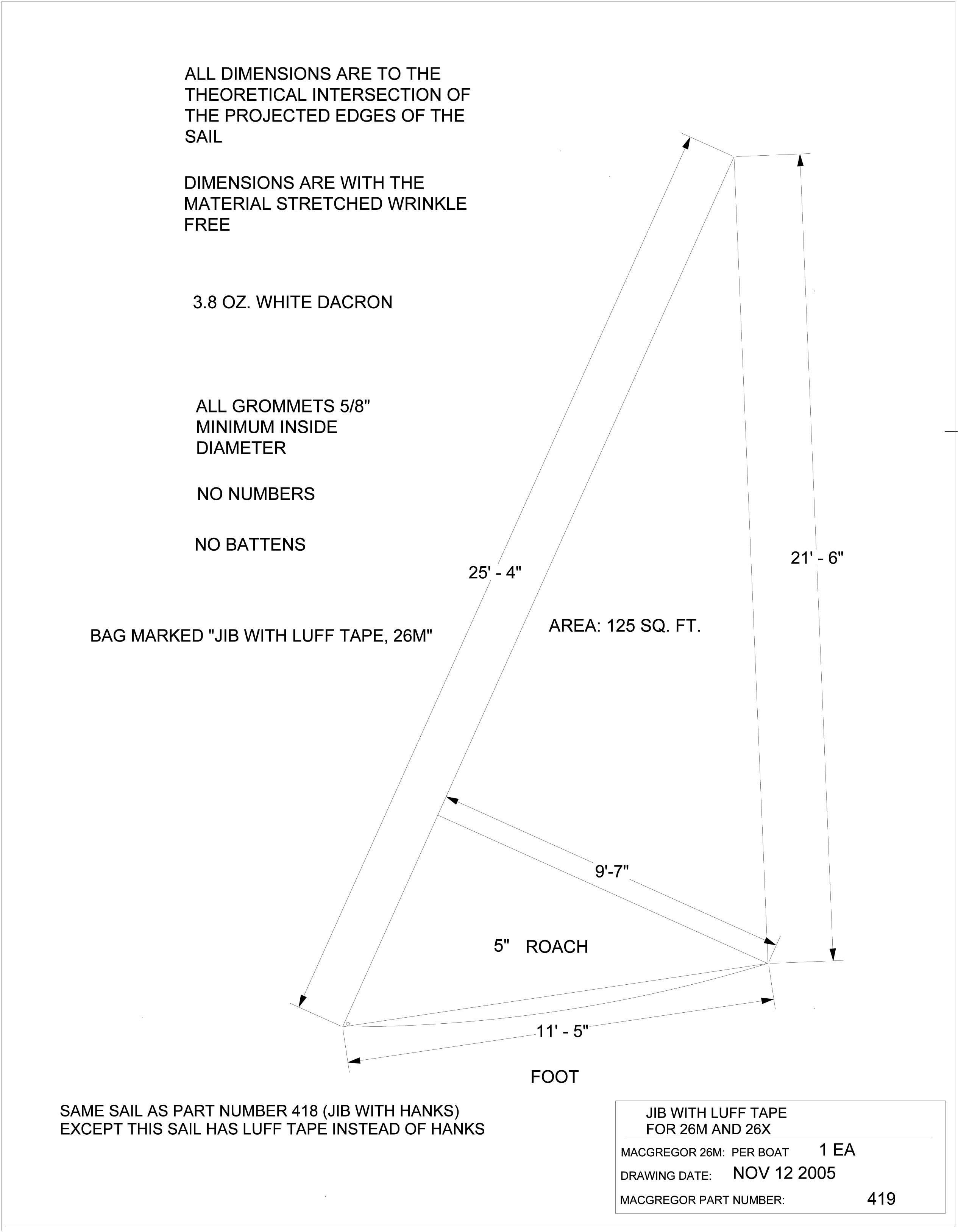

Here is the original factory drawing for a 26M jib
Kadet's dimensions are shorter on the luff, longer on the leech and foot, and bigger in terms of area by 12 square feet. The LP is 3.39 meters (11.2'), so it's technically a 110%.
To sheet to the cabin top decks, and to avoid hitting the shrouds when the the sailmaker dropped the head by 5 inches, and put a significant hollow in the luff.
I would expect that Kadet's custom jib works just fine. It might point a tiny click lower than the OEM design, due to the shorter luff --> reduced overlap with the mainsail -->> therefore reduced upwash interaction between the mainsail and jib.

The exact same jib is used on the 26X as the 26M by the factory.
The LP for the factory jib is 9.58 feet, when the edges are drawn in 2D (according to the geodesic edges).
A real sail has draft built into it (3D shape). The LP is measured to include the curved of the draft, and would be a percent or two bigger than 9.58 feet -
The commonly accepted value for J on both the M and X is 9.7 feet.
That's makes the LP% on the jib = 100%
But maybe, the published J values are wrong? Maybe they are different between the two boats, or are just plain wrong?
