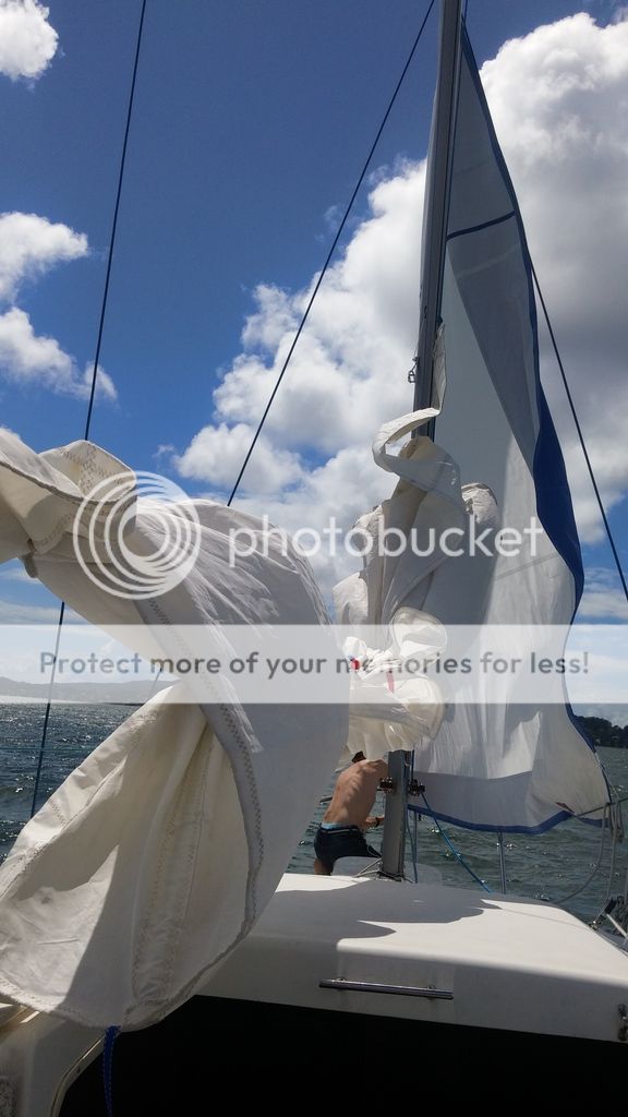

Below is a shot of my wild day out (snapped by the admiral). I was too busy trying to fix the furler to get a shot of the new Jib before the furler jammed .... Next time :wink:

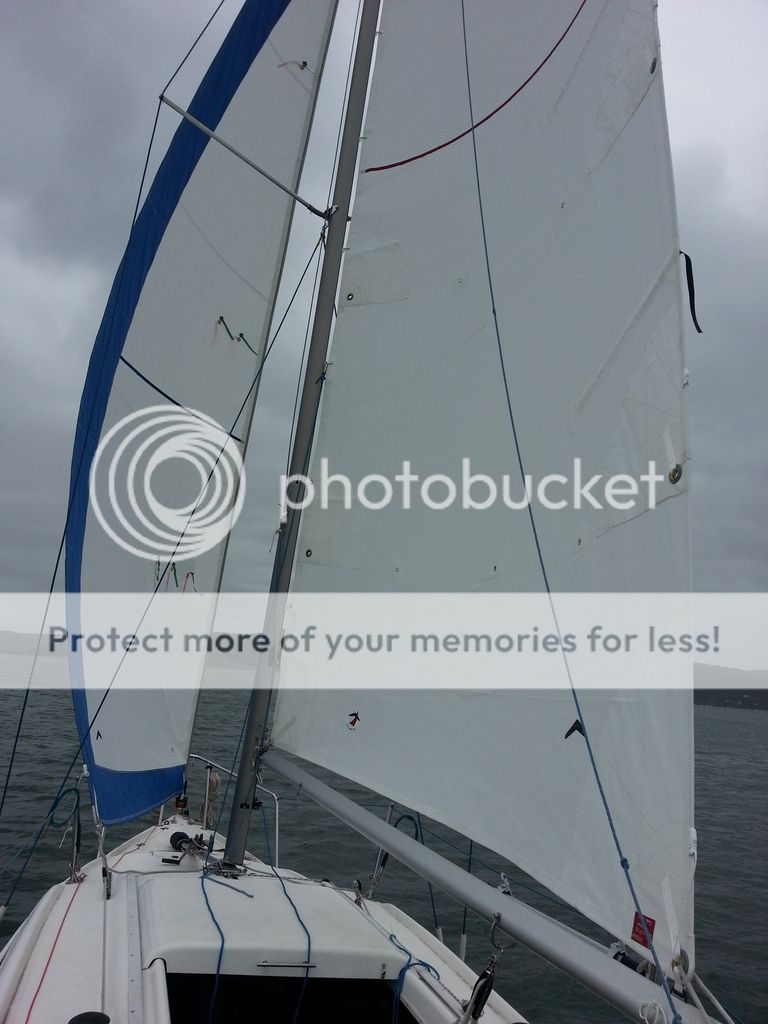

Going around the front pulpit and under the port bow cleat, using my new 5mm Dyneema Core rope, worked really well yesterday ... Thanks for your help guys. :)
Also got the Jib and the new Main flying well too.
Winds were lite yesterday but my two new sails popped into shape even when there was next to no wind :)
