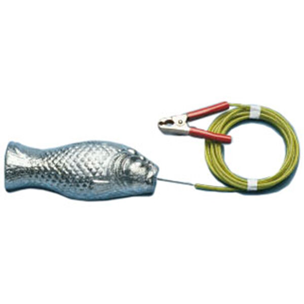

My dad used a zinc "fish" on his boat. He would clamp the clip to the propeller shaft inside the boat and hang the "fish" over the side for extra protection.
I would probably get something like this to supplement the motor anodes.
