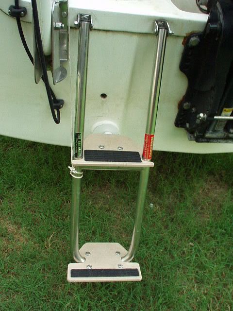

I have those bolt on flats like Scott has. Works great.
I did 2 other things also.
1) hang a web strap tied in a loop from a large padeye that I installed where I removed the back seat hinge. It makes a great hand hold at any height from the water until you are standing on the stern. If you paddle an inflatable dingy or kayak, it is the first thing I grab when returning to the boat. Left hand grabs the web, right hand on top of the motor and boarding is very easy.
2) The right standoff leg did not reach the back of the boat on mine, so I installed a rail stantion base over the leg which made it hit the stern perfectly, makeing the ladder much stronger and more stable.

We have a larger one mounted on the outside of the port rudder. It's not too hard to use in conjuction with the grab handle mounted about halfway up the stern above it. Our kids manage fine, but I still find it tough after a ride on the knee board when my arms are pooped. Some treads might help. A higher second handle also would be even better.
Having it outboard makes it a bit easier to step from it to the aft opening provided the rudder is down. This however means you are constantly putting the rudder up and down as we primarily use it with water toys and need the rudder up to go fast.
You can also use the motor cavitation plate as a foothold if needed (motor off always).
