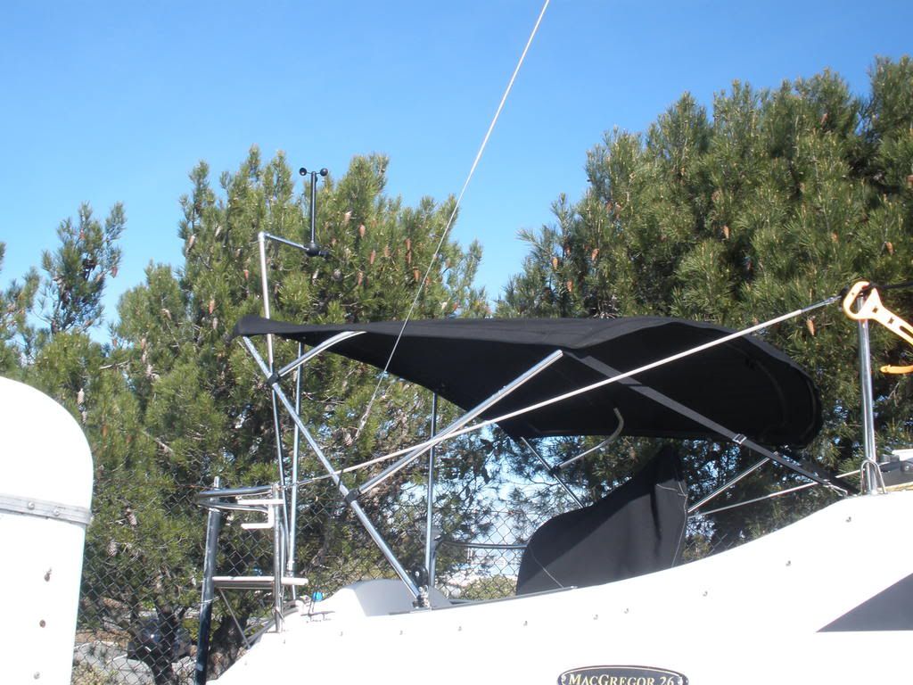

Nobody is giving up a bimini. Mine is part of a full enclosure. C'mon, I'm not stupid. Basically, the choice is, sail with the backstay, or sail with the bimini/enclosure. You can't use both at the same time. That's it. The backstay fits nicely with the bimini ratracted. If I want to set the bimini, I just slack the backstay and clip it to the starboard stancion with a bunjee to get it out of the way. I figure this isn't much of a compromise since the backstay would be used in heavier winds, and at that point, I would want the bimini retracted anyway. I'll take some pix soon.

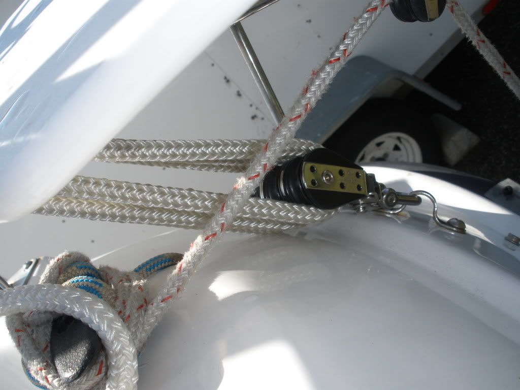

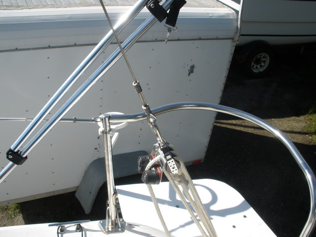

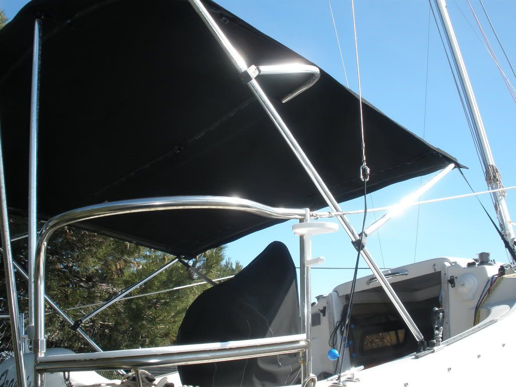

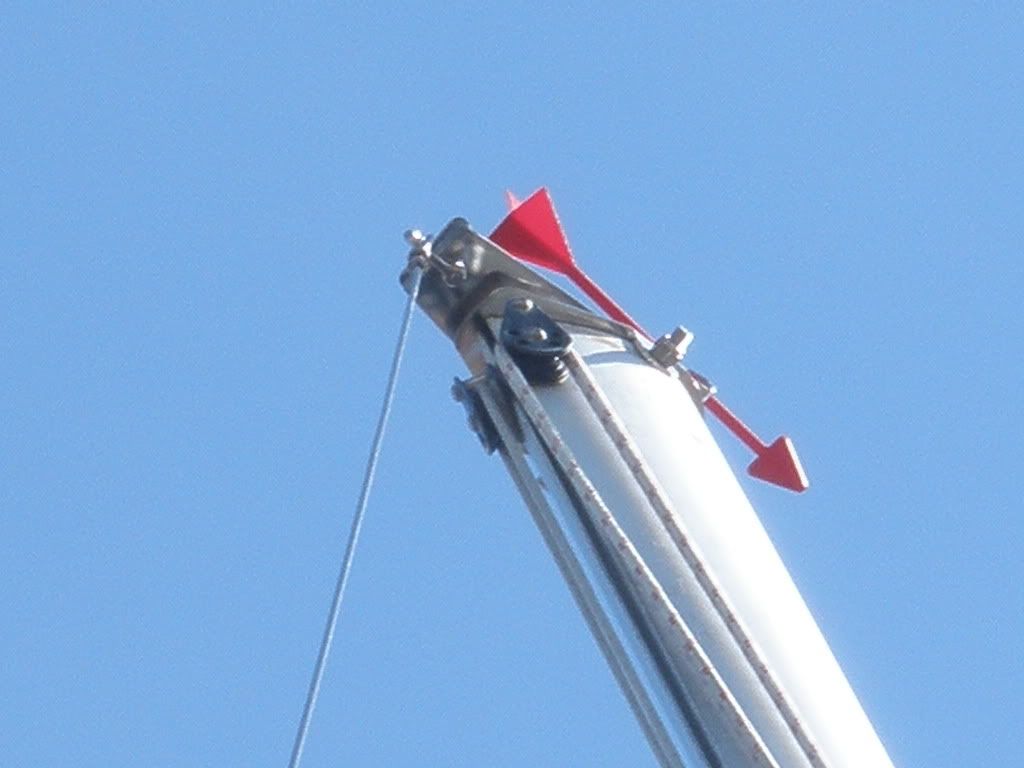

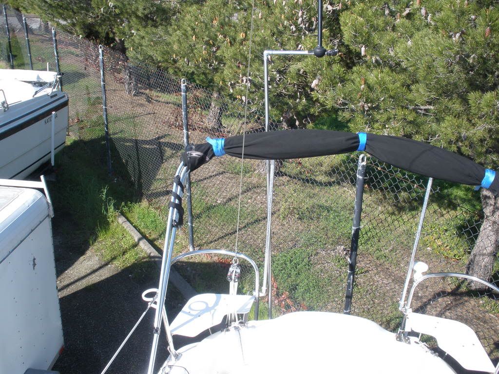

Backstay disconnected and to the side to use bimini. (can also be walked forward and clipped at the mast.)
Swiveling masthead attachment
Bimini retracted, backstay connected
6:1 block & tackle w/ cam cleat
Attachemnt point under stern rail seat

The horn cleat doesn't hold the backstay. Just the eye on the stern which is through-bolted and was designed to hold the aft lifeline for a setup without stern rail seats. I was assured it's plenty strong (the fiberglass back there is thick.)
As for an arch, it is an idea I have pondered, however attachment is the issue. I don't see a way to get on the backside of that fiberglass. It would also have to sit behind the bimini and higher, thus reaching for the backstay adjuster would be an issue. This system is simple and does the job, so I'll leave it at that.
Leon

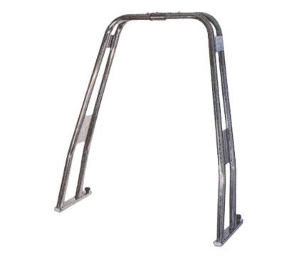

I think this is a nice set-up & adjustable around $500. though not bad not sure if the sizes are good enough 3' 11" H x max W 7' 10"
I,ve been asked so here it is Rekord Marine site made by Victory Hardware

John,
Less than 4' high is a good height to smack your head into a metal arch
Looks like it mounts on the genny tracks and big enough to take over the whole track. Doesn't appear to be the right fit. An arch on the back OTOH would need to be about 6' high. That's the length of the SS post for my wind transducer to get good clearance above the bimini. I still wouldn't go there. It can't be permanently mounted since it's too high for mast lowering... would need to be removed and swapped with the standard mast arch. Just seems like the whole deal is way more trouble than any potential upside. The one good thing, if it can be pulled off, is it would allow for one to have the backstay connected with the bimini in use, and perhaps even the full enclosure. OTOH, when one needs to tighten a backstay, it's probably too windy to have the bimini up. I've had mine up in 25 kts, but it looked scarry. Plus at that point, you really don't want anything to block your view of the mainsail. You'll be working too hard to worry about getting shade
My setup can actually be easily altered as a wishbone setup, though not necessary and would interfere with the raising of the seat. Better yet, it can be used as a runner. Very easy to disconnect from its attachment on the stern and swapped to the other side which has an identical eye on the port side. This is probably how I will use it when I wish to exert the extra ewffort for max performance. I will also intsall rotation limiters to limit rotation to about 10-15 degrees. I believe this will be ideal for close hauled and with the backstay shackled to the leeward side, would line it and the swivel to be pulling directly aft (not sideways) on the rotated mast. The rotation limiters will be on block and tackle systems, held at the front of the jib tracks. I'll be able to slack off for full rotation when sailing on a reach. I don't think I will run the controls aft, so would require a trip on deck. No big deal since it would only be slacked in lighter air. IN heavy air, I want to keep the mast either at minimum rotation or pinned center line. My theory is that having a straight mast (without curvature of 50 degree rotation) as well as minimum draft (which would increase at the 50 degree rotation) will far exceed any benefit of cleaner windflow on the leeward side of the main. Depowering is key in heavy air, and I want the rig as stable as possible. Will let you know how it turns out.
Leon
