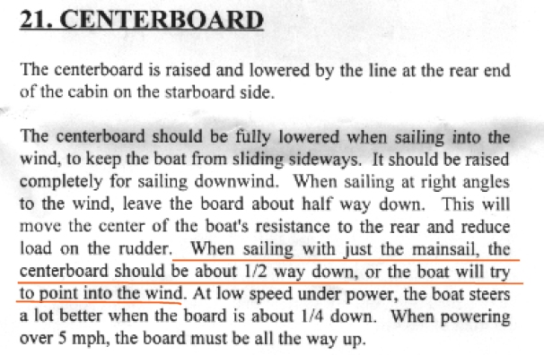

On an X, the center of resistance moves aft when the board is partially raised. This will have the effect of moving the bow leeward with consistent sail trim. Not sure what is going on in your case, Opie. Perhaps the reduced angle of heel is interacting with your particular trim/tuning?

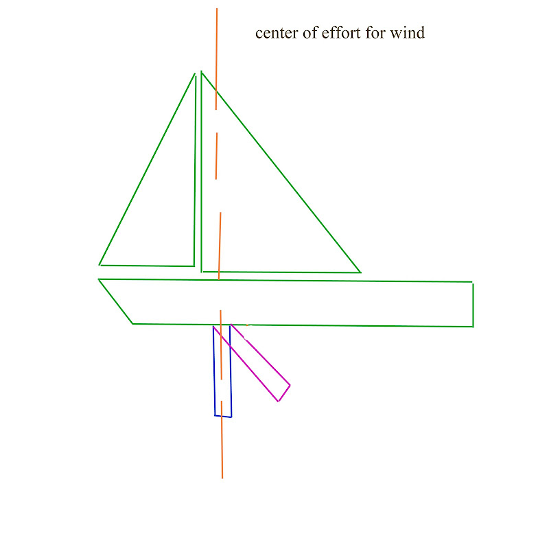

Anyway, my rationalization for what is going on is this sketch.
Where the pivot point moves under the mainsail when there is no foresail and needs to be matched with the CB partially down.
With a foresail the full CB down would be proper as the pivot point or what I call the center of effort would be moved forward to the CB vertical point and matched properly. I am not sure about a M boat, are both sails are needed to tack well with an M's daggerboard?

I am just following my X factory manual, and it works...Not sure what is going on in your case, Opie.

Opie, you are confusing center of effort (COE), with center of resistance (COR). COE is where the push is, or what the wind is affecting, COR is what is preventing the side slipping. The centerboard (CB) only affects resistance and sails, effort. When sailing on main alone, the center of effort is moved aft and requires the CB to be raised a bit, in order to move the COR aft to balance the boat. But, this should not allow the boat to point higher, only reduce weather helm, which is the tendency for the boat to want to turn toward the wind. To make the boat point higher with more velocity make good (VMG) to your target, you need two things: More power from the sails and less heeling. This requires a balanced sail plan and flatter sails. Tightening the backstay to induce mast bend will help flatten the main, as will tightening the boom vang and outhaul. If you are heeling too much, you probably have improper trim, or blown out sails. As your manual says though, when sailing to windward, the CB should be fully down, unless you are on main alone. in that case, you need to pull the board a bit for balance, but you will sacrifice pointing ability, or you will side slip to leeward during the tack. Neither of which is desirable.

Opie....I agree..Our 2001 X, in winds high enuf to require mainsail only, sails nicely to windward and tacks easily and has a balanced helm, with about 3/8 of the CB line let out. Center of effort is positioned aft, so center of lateral resistance has to be correspondingly shifted aft.
If the wind drops enuf to set the working jib, our helm balances with about 7/8 of the CB line let out. Center of effort is thus shifted forward, so center of lateral resistance has to be correspondingly shifted forward.

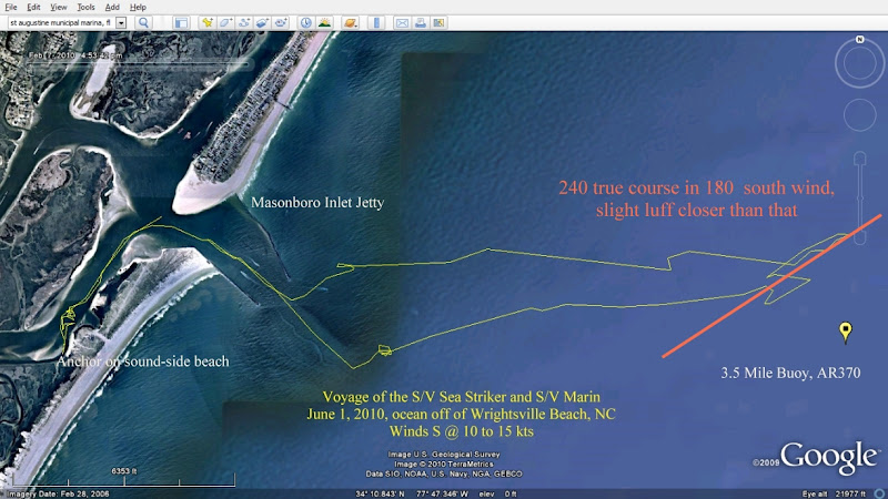

Here is a trac-pic of a brand new M and my old X sailing in the Atlantic near shore. One track shown, mine, but we were together.
Ignore some of the other points of the tracks as we were fooling around some and the broad reach back to the jetty (the furthest south track) was just angled to make the sea buoy before bringing down the mast. Too choppy in the inlet to sail between rocks in our opinion.
My point is, on two reaches shown upon returning south, we both could only do 240 true in 180 true wind before luffing as shown on pic below. I will continue to re-read your suggestions and try again next time. Maybe someone else could post some trac-pics of better close hauling toward 50 degrees with proper trim....
