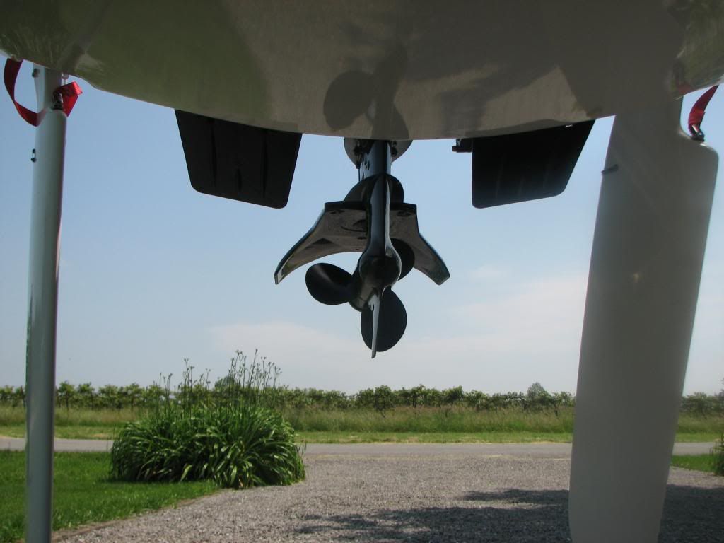

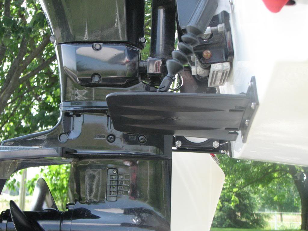

They're on!
Thought I'd post a pre-running status report of the installation. Had I known what a hassle it was going to be re-positioning the ballast valve I might have chickened out before things got started! There was only one position possible for these baby's, which was determined largely by the stern gate mounting, and the rudder and engine port-to-starboard swing. When I took the waste gate off I found it was secured only by the screw threads biting the fiber glass. No inside nuts! :o What I've done looks a little funky but should work just as well as the original, and will be replaced shortly by a Valterra 12v RV equivalent for easier operation by the Admiral, as well as a binnacle status light for the geek side of me. Overall, it's pretty strong now (as long as no one steps on it!) with washers and nuts holding it on in the interior space.
They have a deployed and retracted capability that can be utilized for either power or sail.
We should be in the water soon, then I will have to tinker with the 60lb gas strut positions for getting the right amount of automatic activation.
If the crash dummy survives the test he'll report back with some travelling video shots, for your evening entertainment. :?
Ross.

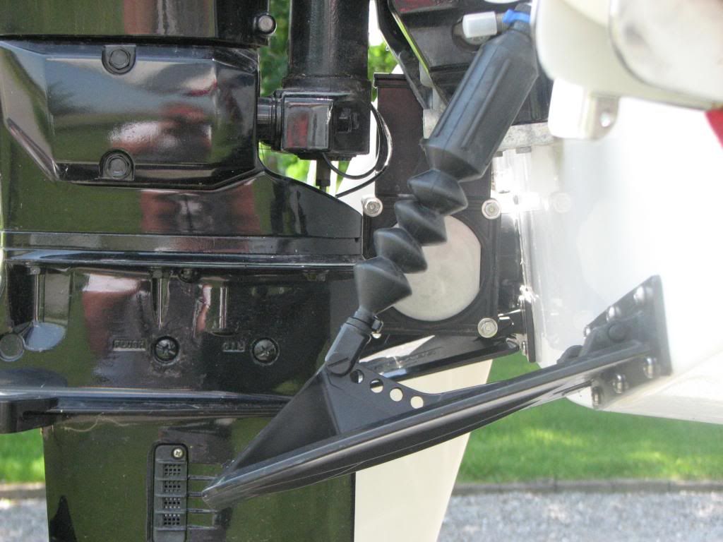

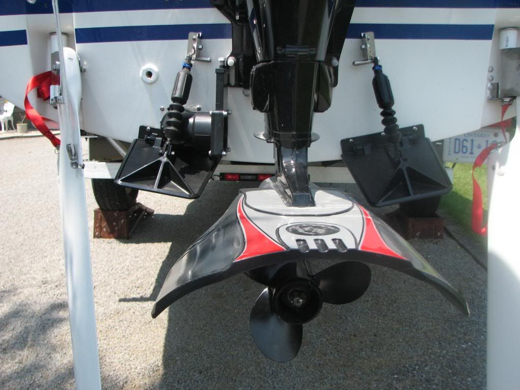

Here's a couple more pic's:
The waste gate is 3" ABS compatible (these pictures show the assembly dry-run before sealant and epoxying).
R.

Looking good Ross
But thats an aufully small prop on that teeny weeny eng. :P
What happened to ur dorsal fins u had on the rudders ! Sharky got too them :P

Highlander wrote:Looking good Ross
John, it's not the size of the prop that counts. It's the amount of rotation! :D
Yes the Mako fins had to go for now as they were both on the same side due to the rudder bracket design, and the starboard side would've hit the Tab. Next edition will use a much larger pair of $35 Doel fins angled out 30deg on each side, still turning with the rudders. However, I'd have to take everything apart again. Probably won't happen this season - the Admiral would deep six me! :(
