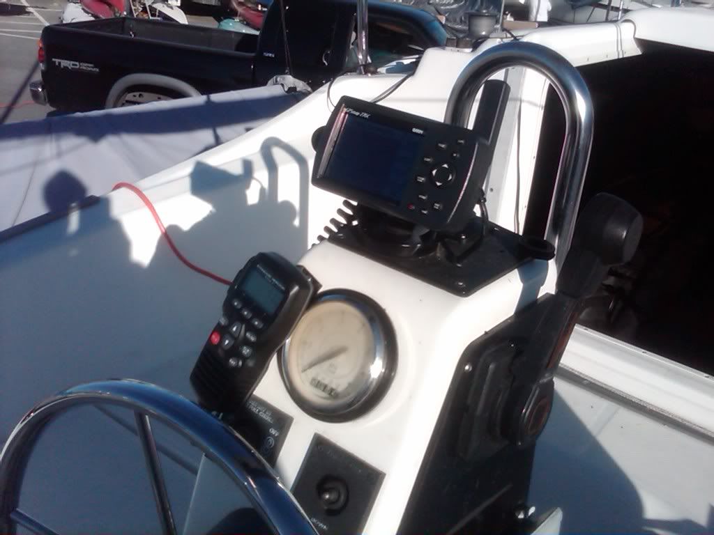

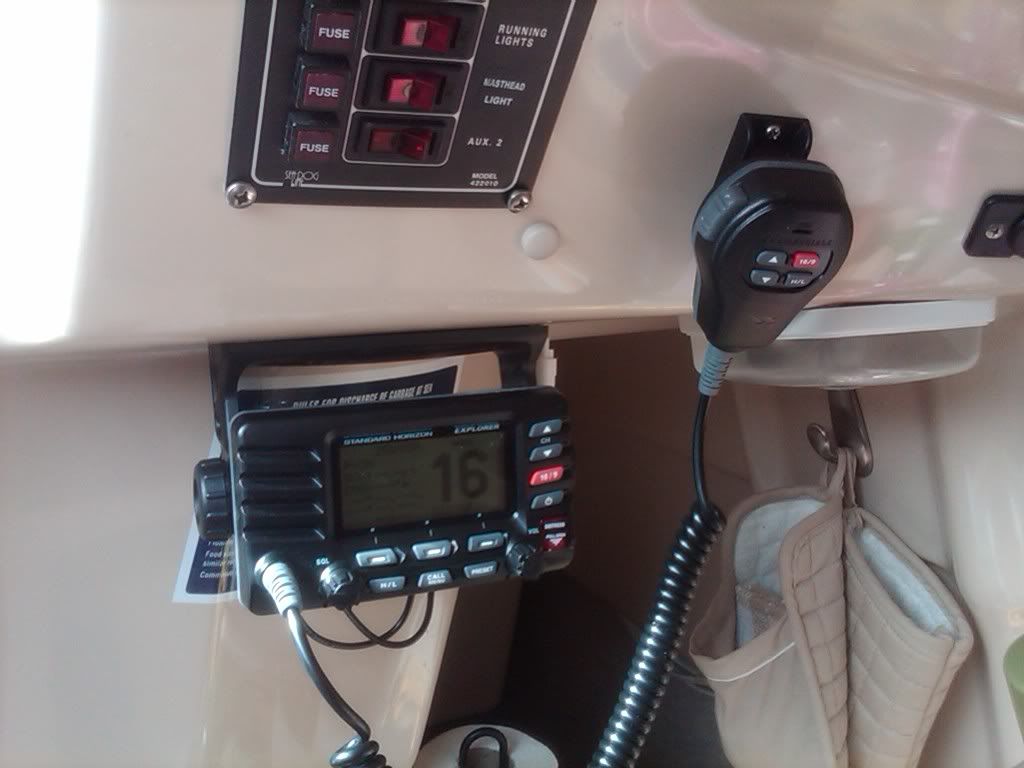

I have the Standard Horizon GX1600, with RAM mic, and I love it. Having the remote mic readily available at the helm is very convenient. The radio is mounted near the fuse panel of the 26M.
Antenna is a 6 dB gain mounted on the stern rail.
Roger

I've just realized I can use my handheld VHF for anchoring ops, and it floats. So I'll helm mount the remote mic and put the VHF inside.
