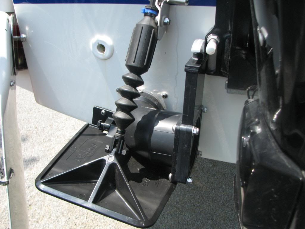

Do not use 4200. Note that 3M indicates that 5200 is compatible with ABS, but it also makes a permanent bond.

You can also go with one of the Boatlife Life Calk products. There are 2 varieties, with the difference being the material it is being applied to. DO NOT use 5200. The gate valve may need changing again in the future and it will be mighty tough getting those bolts out.

Srdjan, there might be a way that you can still use the 5200 because it is compatible with ABS but tone down its adhesive abilities to the transom gel coat in a similar way. I would suggest trying a coat of wax on the gel coat in an inconspicuous spot and try a dab of 5200 on it. If the wax prevents good adhesion and the bead releases when set, and there is no degradation at the bead surface, then use it around the hole in the transom. If not, try something else, maybe a layer of petroleum jelly wiped thin? Wax paper? WD-40? Etc? You could use the same on the threads of the mounting screws.
The next time the valve needs to be replaced the 5200 will come off the transom with the valve. Just a thought.

We use 3M 5200 sealant
I guess that settles it. I hope I will be able to remove the old sealant : )

That's the problem with 5200. It's permanent. That's why I would use 4200. If the seal leaks, your ballast tank fills up. No big deal as most of the time we want the ballast full anyway.richter372001 wrote:Tattoo:
If you don't plan on removing the valve again, 5200 is fine.

Holy smacks, use the 5200. It's not that hard to get off especially with plastic parts. I have had the sliding hatch rails, clutches, pulleys, fairleads, cam cleats and centerboard on and off more than once and all set with 5200.

To be honest, this is not really that big of an issue. All the sealant is doing is to bed in the valve. Use whatever is handy. There are no high pressure leaks that need to be prevented, nor any danger if there is a leak. All you are doing is attaching a ballast valve where if there is a leak, there are no problems. My personal opinion would use something that would hold but not prevent disassembly in the future. The factory likely uses 5200 since it works for everything and they do not want two kinds of sealant on the shop floor. Even if you do use 5200, the bond line is accessible with a razor blade.
Put your valve on and go sailing.

Any sealer you use needs to protect the screw holes from water intrusion where damage from freezing could occur. Other than that, it's meant to have water on both sides.

When I removed my broken, 10 year old valve some of the gel coat came off with it. After repairing that, I sealed my new valve with a large O-ring. Used a little 4200 in the screw holes.
