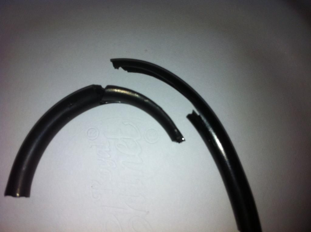

My Merc 75 HP 4stroke EFI 2008 has 13,000hrs on it & still ticking
I had issues with it the last 2 yrs with bad ethonol gas , Merc Mechanics now told me to use ethonol gas treatment all season long now instead of just at the end of the season , the ethonol gas was breaking down the internal eng. fuel lines making them brittle & breaking down , Merc is now making the internal fuel lines from a diff material because of this issue
Here,s the fuel line in question
http://i844.photobucket.com/albums/ab1/ ... 769c0b.jpg
As u can see it became so brittle it just split apart
http://i844.photobucket.com/albums/ab1/ ... 5524c3.jpg

Yes, never use Ethanol gasoline in an engine with rubber components. Boat engines were not updated to run Ethanol gas until the mid 90's, so do not use it on those engines. Ethanol will extract H2O from rubber, leaving it brittle until it breaks. Modern engines are built with hoses and gaskets based on silicon rather than natural rubber and don't have this problem.
Interestingly, even brand new diesels still use rubber hoses though. They're much easier to install and work with.

Hi wake up this is a 2008 eng, these r not rubber fuel lines these r synthetic fuel lines & have since been up-date by Merc again !!! think again ??? Problem is with all the crooked sharks out there u really just do not know what kinda crap u r buying when u filler up !mastreb wrote:Yes, never use Ethanol gasoline in an engine with rubber components. Boat engines were not updated to run Ethanol gas until the mid 90's, so do not use it on those engines. Ethanol will extract H2O from rubber, leaving it brittle until it breaks. Modern engines are built with hoses and gaskets based on silicon rather than natural rubber and don't have this problem.

Yes they are rubber and they are most probably some form of Nitrile rubber a synthetic rubber that is used widely in the auto and aviation industry just because it doesn't come from a rubber tree doesn't mean it's not rubber. These synthetic elastomers are more resistant to fuel than natural rubber but can still be affected by ethanol. Newer fuel lines designed for ethanol have a coating of another synthetic rubber called fluoroelastomer to protect them.Highlander wrote:
