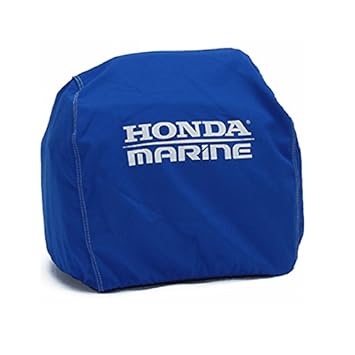

In addition, there are a wide range of accessories made or the Honda (see the Honda website and places like eBay & Amazon) which add flexibility to the unit, including such things as propane & natural gas fuel conversion, extended run fuel hookups, lock-down brackets and boxes, oil-changing devices, fabric covers (including a nice "Honda Marine" one in Sunbrella blue - I couldn't resist buying one for mine) and even attachable light units (though the latter has little use on a boat!).

And I know it's silly, but the cover is kinda cool... it exactly matches my sail cover and bimini.
