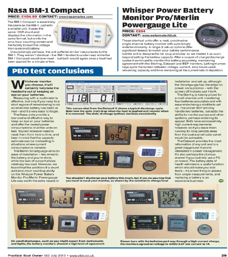

C Buchs wrote:I'm very interested in what everyone is using. Right now I have no way of knowing what condition my batteries are in without using my volt meter (I do have one on board). My brother-in-law recommended a Xantrex Link Pro like this one http://www.amazon.com/gp/product/B001E4 ... PDKIKX0DER. However, he has a 40 foot Nauticat that he sailed solo to Hawaii. He’s got a bank of eight gel batteries. I’m willing to pay for it if it’s worth it. Is this one overkill for a boat with two batteries that is mostly used for overnighters on the weekend and will hopefully take us for a week long cruise this year?

Boat, I gave up trying to figure out all that shunt stuff and forked over the $300 for the Balmar smart gauge. Just hook it up to the battery positive and negative. Gives you volts and percent of charge on two battery banks. Lot of money but only 2 wires. That "compass marine" guy sells them.

The smart gauge seems like the winner in simplicity and being idiot proof, from phase review:
"thankfully Smart Gauge uses no shunt, it is a shunt-less design. This means there are no large gauge battery lugs to crimp, no large gauge jumper wires to make up, and there is no complicated programing beyond selecting the battery type. This makes the Smart Gauge a DIY's dream battery monitor. Easy, simple, never needs programing and stays accurate despite temperature, battery age/condition or a nuclear holocaust. Just seeing if you are still paying attention..."
However to clarify ris's info, I think he meant 'Gives you volts on two battery banks and state of charge on one'
However, it does not provide amps like the ones with shunts do.

Between the two the Blue sea system is clearly the winner in features and amount of information. Sounds like the price is almost identical. In installation the Smart gauge may be slightly easier but who cares. Installing a shunt is not that difficult. Just cut the power wire if you do not have a terminal swag tool just get a torch and solder the lugs on. But some boots over the ends to protect. If you want another shunt in the system just get one and wire both thru a DPDT switch. You realy only need to monitor your house load. The only reason you would need to monitor your engine starting load is for troubleshooting.

Ok, here is my problem grady, (and this is of course addressed to Sumner and Dave and Seapup too) - I actually read all the stuff about the Balmer thinking that if I pretended I was Sumner I would actually understand it. I did not, but I did get one thing from that post - the guy with all that electronic 'stuff' said that the Balmer unit will "learn" about the condition of your battery as it ages and adjust it's readings accordingly. This I did understand because I have noticed that MY batteries seem to change their personality as the get older - just like me; batteries, get slower and grumpy as they age.grady wrote:Don't worry about the difficulty you will have plenty of help.

Let the smart guys now debate - we have a 'learning robot' by Balmer that realizes your battery changes over time and then we have the Blue Sea Systems gauge that matches our other panels. Which way to go?

Re: Best battery monitors? And low voltage cutoff?
WHOA!! Okay seapup get the award for most info I could never understand - so did they ever make any conclusions? Did any of you smart guys read this stuff to see which one is the best for a factory stock 2 battery MAC setup?
Is there a link we need to read seapup? (Or is this all in some print mag?)
